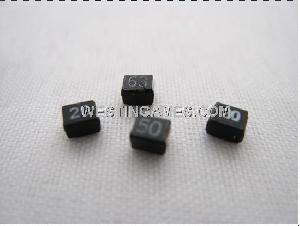

  9. APE
    The only fuses I'm currently aware of - there might be more but I've always fixed whatever problem I've had with these - are in the bottom left part of the motherboard near the power and laser ribbon connectors.
    They look like this for the most part:
    I'm not 100% sure of the values anymore but I have used the PS2 value charts to replace them and I've yet to have anything explode or die on me as a result. Though this does not mean the value system is identical. Check them for a short, if the fuse reads as shorted it is good. If it reads as open it has blown and needs to be replaced.
    A really stupid way to check this is to bridge the pads the fuse sits on top of to see if it works again. Obviously if the fuse blew it blew for a reason and shorting the space it formerly occupied could lead to even bigger problems that aren't easily fixed; or fixed at all.

    Yup, but just bare in mind that they changed them in the second revision Psone Consoles, to the smaller ones :)
    PS The first models fuses are located http://psx-scene.com/forums/attachments/f10/2056d1061087139-newz-psone-board-fuses-ps1_fuses00.jpg , the second models ones are more or less in the same place, there easy enough to spot
    What ever you do dont do that a meter is dirt cheap and you dont need a good one just to check for continuity ,bridging all of them can and probably will destroy your PSone :/
  13. APE
    Continuity is the smart way, bridging them is the stupid way that most people get lazy and leave in place because it fixed the problem.
    Unless you're like me and find most problems related to fuses are because of something being shorted against the shielding or controllers that like to pull too much current for rumble. Those get swapped with PPTC fuses so I don't have to crack it back open because I tested a bad controller. Usually the current draw isn't at infinite (short) and is only 50-150ma higher than what the fuse is rated for a split second. Unless your controller is really bent on destroying your PS1.
    Last fuse I blew was on a PS2, the wires for the fan were stuck under part of the metal inside and had enough pressure to dig through the insulation. The fuse promptly blew and it took all of 15 seconds to figure out why the fan wasn't spinning. Quick solder job later and all was good.
    REPLACE FUSES WITH FUSES!
