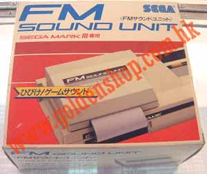

  8. ave
    Some games had FM sound built in, but to activate it you had to buy the FM Sound unit which made the MarkIII look (even more) like a space ship:

    ah cool ave. of course i'm aware oft the FM games, but i didn't know about the FM unit add on yet. cool stuff.

    so that means, the very only ways to enjoy FM is via JPN SMS and MkIII + FM unit?
  13. Calpis
    Calpis Champion of the Forum
    5,906
    As of now, yes if you don't count emulators or mods. Someday a MD adapter may be released but it's becoming increasingly difficult to buy old FM chips so it may be more reasonable to expect a full SMS clone with FM sound in the future.
