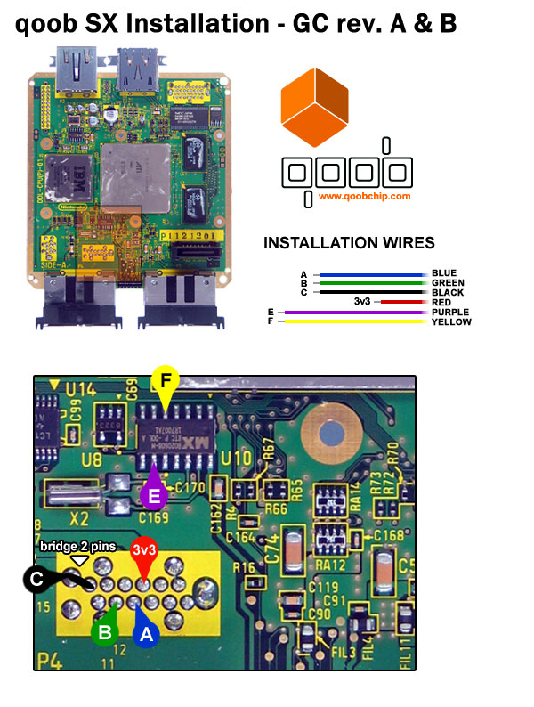

    I've been attempting to install a Qoob SX in a Gamecube for the first time and it's starting to do my head in. I've resoldered and retinned the wires about 5 times now and I always get exactly the same result. The Gamecube boots (or doesn't, but the monitor detects something, possibly just because it's ground) to a black screen and the DVD drive won't spin up. I always get a green light on my Qoob SX, but nothing else, which I assume just indicates the Qoob is getting power.
    I've used the following guide to install it:

    Double check your E and F points , make sure they are not bridged or touching the heatsink.

    E and F are definitely not touching the heatsink or bridged.
