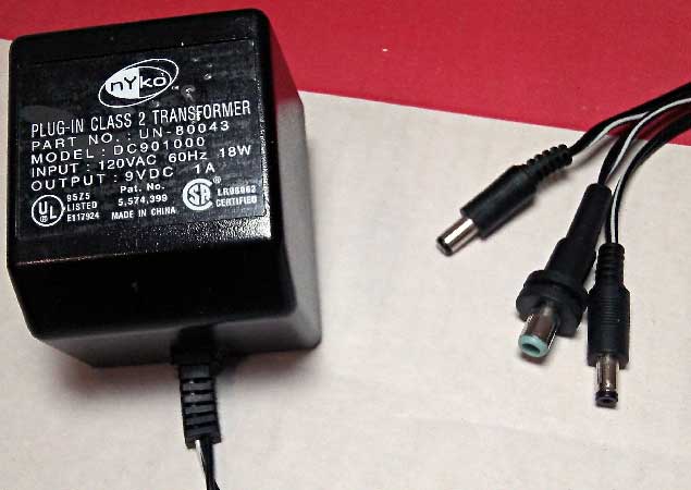

    Hi guys, hopefully this is the right forum for this.
    I recently found this Nyko Ac Adapter while cleaning around the house, and have forgotten for which game console it is for, as it has 3 plugs. I believe it was SNES (blue tip), Genesis 1 and NES, but I'm not sure and I no longer have the consoles here to test. I can't seem to find any info about it online using brand and part number. Any chance anyone here can confirm if it is for those 3 consoles? I have attached a picture of it. Thanks.

    Very likely. If so, that means center negative output. Should be more or less safe for Master System, Virtual Boy, Commodore 16...
    Genesis 1 recommends 1.2A. Might not want to use any heavy power-draw stuff on it.
