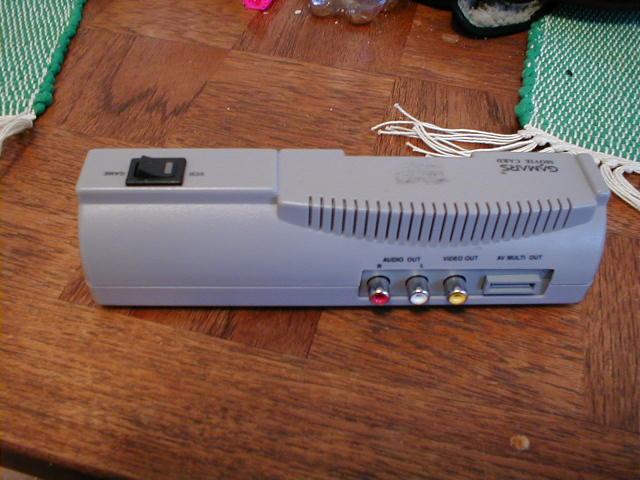

  3. MottZilla
    Feb 1, 2006
    5,066
    102
  4. madhatter256
    6,578
    Made in China... NOpe, not sony... Lik Sang used to carry those because I remember that exact shape and it is what you posted.
    I believe that model uses the swap trick though...

    But the discs aren't valid PS1 game discs. I don't think the PS1 would read from any Mode 2 disc simply because if it could then any GameShark or PAR cartridge could have forced the system to boot burned/bootleg games without a modchip.
    So Sony didn't ever make an official VCD card addon? Which would suggest to me that the VCD players all require a swap trick or modded system. The only except would be that Video-CD PS1 system that has support built in I guess.

    I collect psx vcd units, the hardware hijacks the cd-rom for reading and the psx itself for the menu overlays.
    These cards all have a separate video decoders. I must have a dozen types, all except the rare internal mod.
    Sony made an official VCD psx for southern asia.

    Ah... Thats why they have ports at the end. At first I thought they were just passthrough connectors because the back was so big it would block the regular connectors from making it out.
