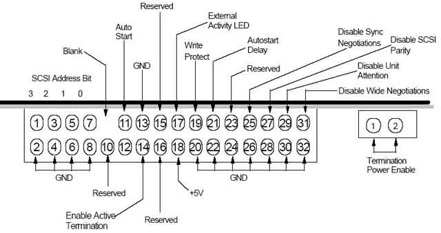

    I have another question about SCSI HDD. I just received a SCSI HDD for my mail. I see there are some jumper setting in front of the HDD. Since I am not familiar with SCSI things. I wondering what jumper setting I have to set for use in dev unit? Thanks again.

    you could check the model's brand and find its manual online....

    Yes I found it. But I have no idea which setting I have to use. I am not familiar with SCSI device at all. Please help. Thanks
