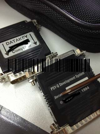

    PSY-Q need dongle
    it come with DTl-SXXX psy-q box

    ^ You don't need one of those to develop with PSY-Q, unless you plan to go for Code Warrior + debugging modules and test on real hardware all the way.

    To use Psy-Q you do NOT need a dongle whatsoever. The dongle imaged here is for the blue 'Psy-Q Development Systems Cartridge' from 1995 (SCEE made it as a cheaper alternative development kit but SCEI didn't like the idea. The rest is history now). It's only needed for the 'Windows 95 Debugger' in conjunction with the 'Psy-Q Server'. Even so, I have a crack for it available. Another useless piece of hardware I'm afraid.

    so no idea why sony unhappy but they still ship the dongle with DTL- BOX with first PSX dev packing list....

    They would have eventually figured out that dongles are a more harmful nuisance to developers than good :)
