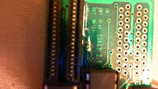

    I recently picked up a mod chip from Alphagamer who purchased it from Trenton and I'm unable to get it to work for my model 2 32pin Saturn The only info I was able to gather was from a French modder darius-saturn post that said it was good for the 64pin version but I'm unsure if its 32pin capable Thanks for any help

    Is there anything I should try I solder the one wire to my 5v on JP Saturn and reversed the 21pin tape and nothing is it possible the the tape connectors are on the wrong side or is universal

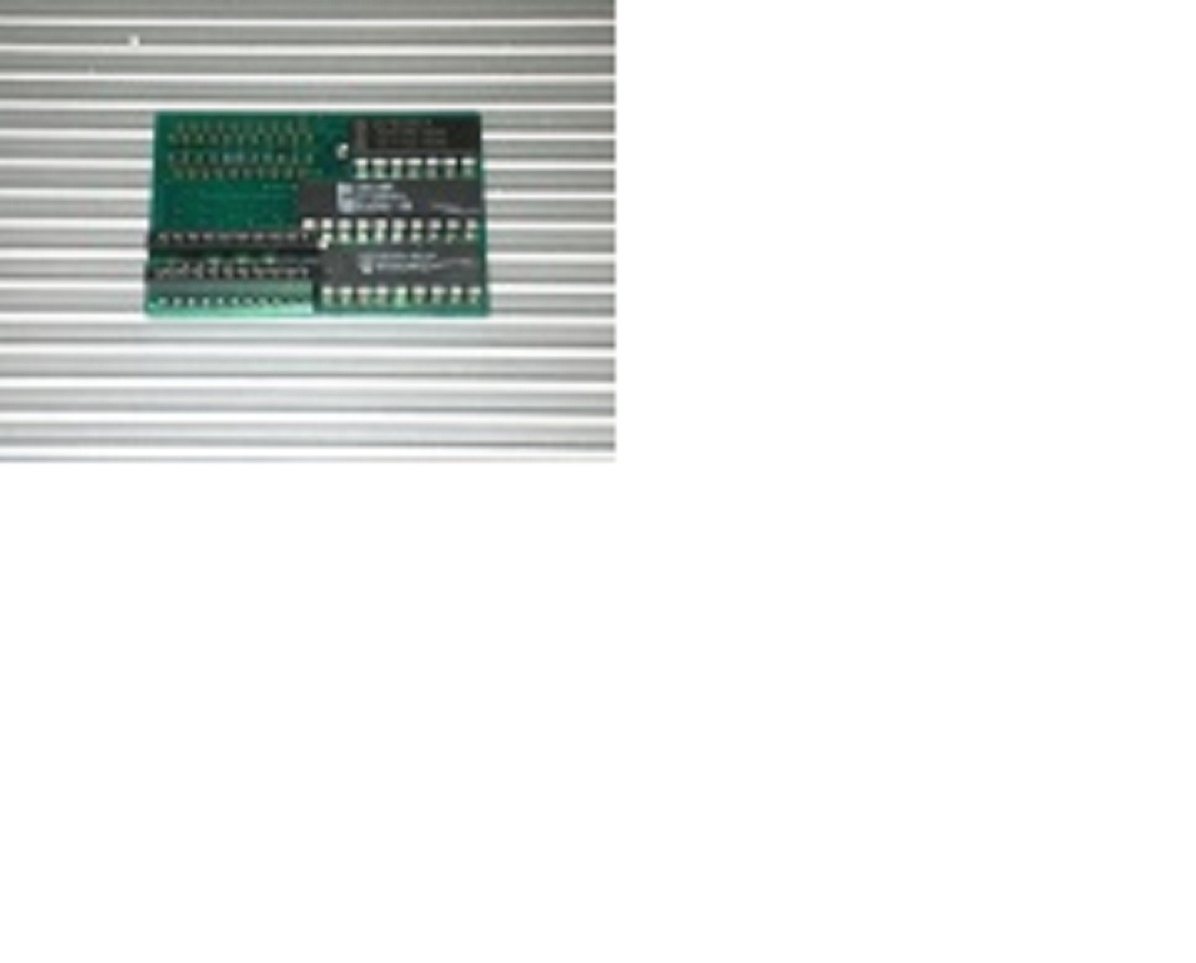

    helas , le pan coupé qui devrait indiquer le dos de la nappe n'est pas respecté sur toutes les puces , certaines on ce connecteur a l'envers !
    mais agrandis la 3eme photo :
    http://www.servimg.com/image_preview.php?i=6825&u=11721023
    les imprimé des nappes , c'est a dire le coté des conducteurs se font face , ca c'est intangible !
    demain je vais continuer l'inventaire et les essais des puces chinoises , j'en ai reçu plein :)
    I would do all my answers in French first and then English google to avoid any worries :)
    alas, the cutaway which should indicate the back of the web is not respected on all chips, some on the connector is upside down!
    but enlarged the 3rd photo:
    the printed sheets, that is to say the drivers side facing each other, that is intangible!
    Tomorrow I will continue the inventory and testing of chips in China, I received a lot :)
    [​IMG] [​IMG] [​IMG]
    acc SAT mod SSKEY 2.1 1
    testée sur V1.3/V2.1 (64pins) = OUI

    So its okay that both connectors face each other the picture in the post above the inner connector is facing outward
    This picture was taken by me of my actual chip
