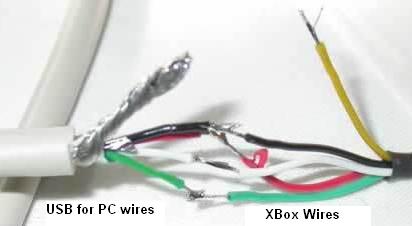

    USB to XBOX Wiring Image
    To make a XBOX to USB cable you only need to slice open a breakaway or a pad cable and then connect a male to female cable they should be colour coded to match except the yellow wire which means you can add it onto the cable without completely destroying one or the other (can't find the guide for this anymore)
