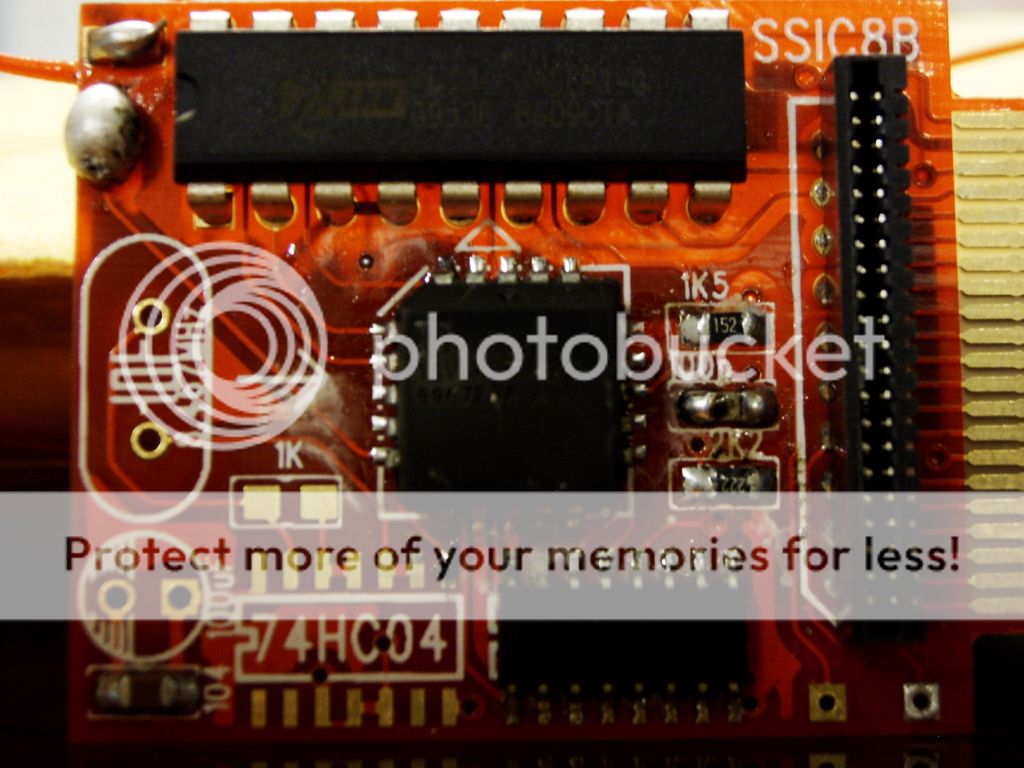

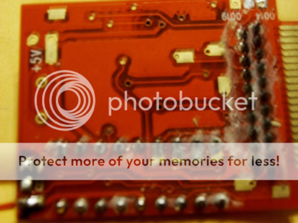

    Heres some pics of the chip itself if it helps any.

  10. Mack
    Aug 26, 2011
    654
    64 pins are just a pain for the most part , they have to be almost perfect for them to work correctly. I fought one for a couple days until it worked to a T , the ribbon needs to be perfect tbh.
