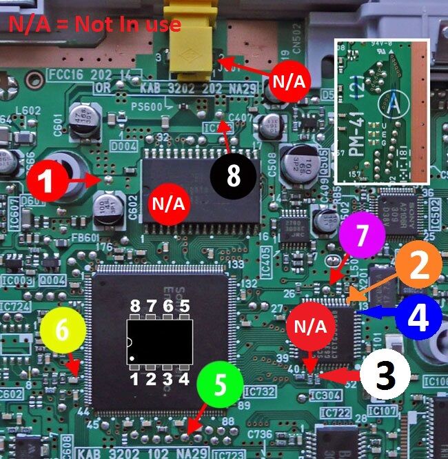

    I did some more reading and it seems like the Mayumi V4 is the best choice for PSone systems? Reliable & stealth? Bad_Ad84 sells those pre-programmed. Presumably you have to specify which region fimware you want. Are these instructions correct:
    https://quade.co/ps1-modchip-guide/mayumi-v4/
    ? They seem to cover both PSone mainboard revisions.

    I looked at the instructions for the Mayumi V4 on PSone in your document, but I find them hard to read. I can barely see what pin 3 is supposed to be connected to, the picture too low resolution. Also, you only have instructions for PM-41, not the PM-41(2) board?

  8. Bad_Ad84
    1,308
    Its connected to the resistor its pointing too. Its pretty clear, especially if you have the console open in front of you.
    PM-41(2) board install attached
