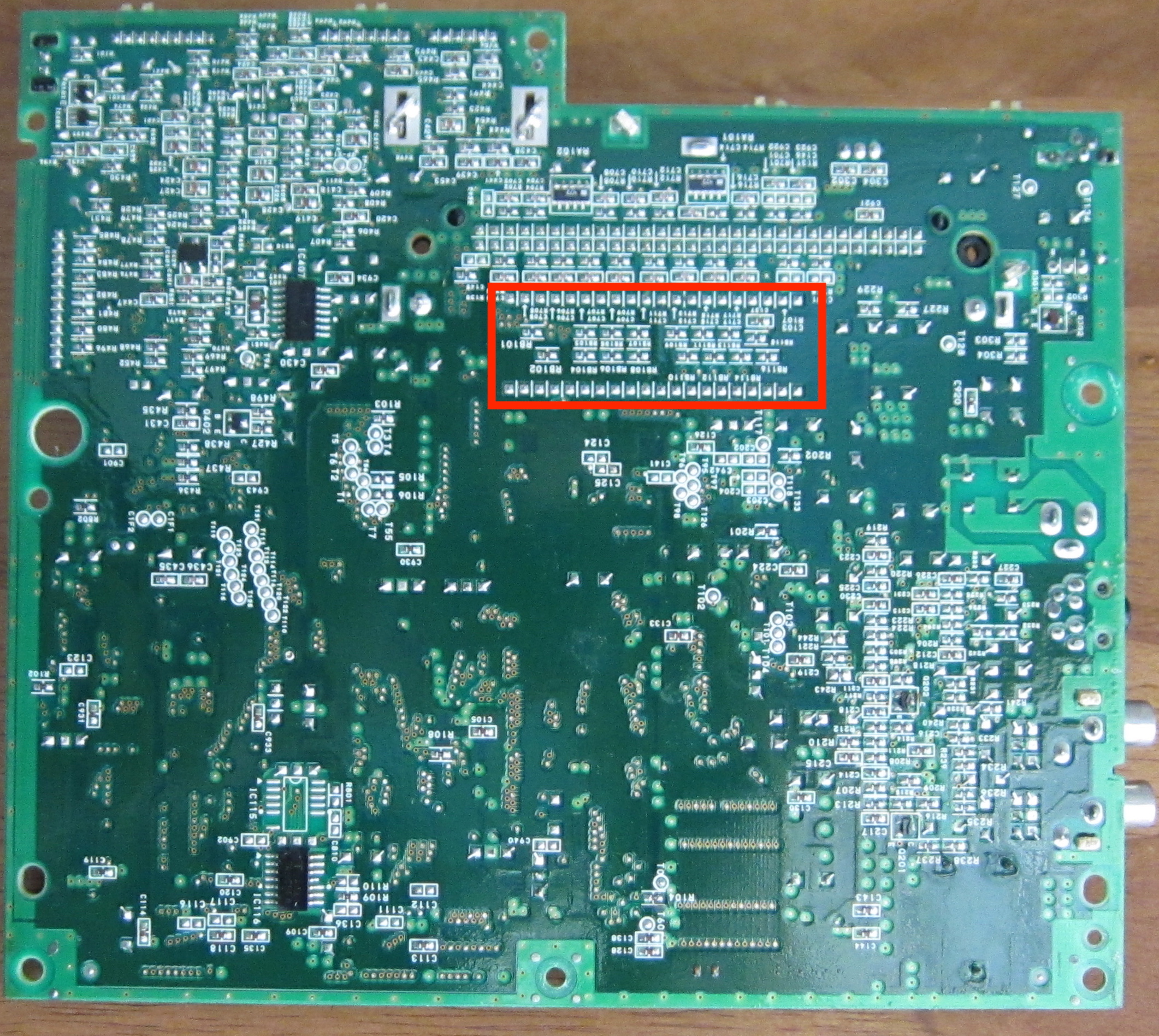

    I'm trying to remove the stock BIOS on my Sega CD so I can install a socket & region free BIOS. But I have only been able to desolder one side of the original BIOS. Is there a secrete technique to doing this mod without destroying the original BIOS? Clipping the legs is the only way I see of getting the original chip out.

    I thought the picture made the issue clear. The BIOS chip is located underneath the expansion connector. There is no way to reach the pins on the other side of the chip with the soldering iron.

    Get that board out of the case if it's still in there and flip it over, you'll see the back solder pads as it is through-hole soldering. Your target are the pads in the red box, clear 'em out! Solder will melt right through from the other side. What method were you using to remove the solder so far? Solder sucker? Desolder braid? Hakko 808? *Drools*
