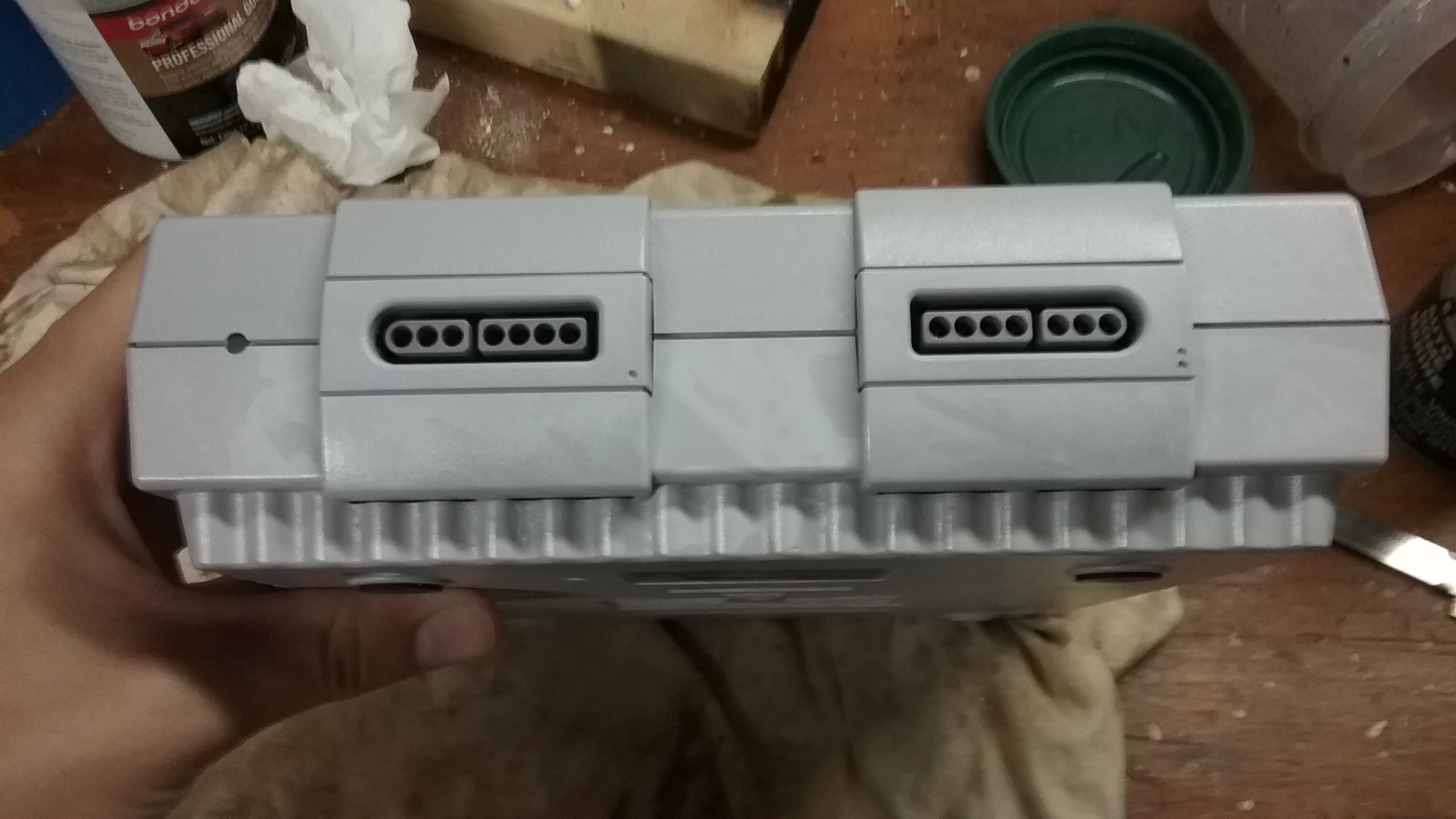

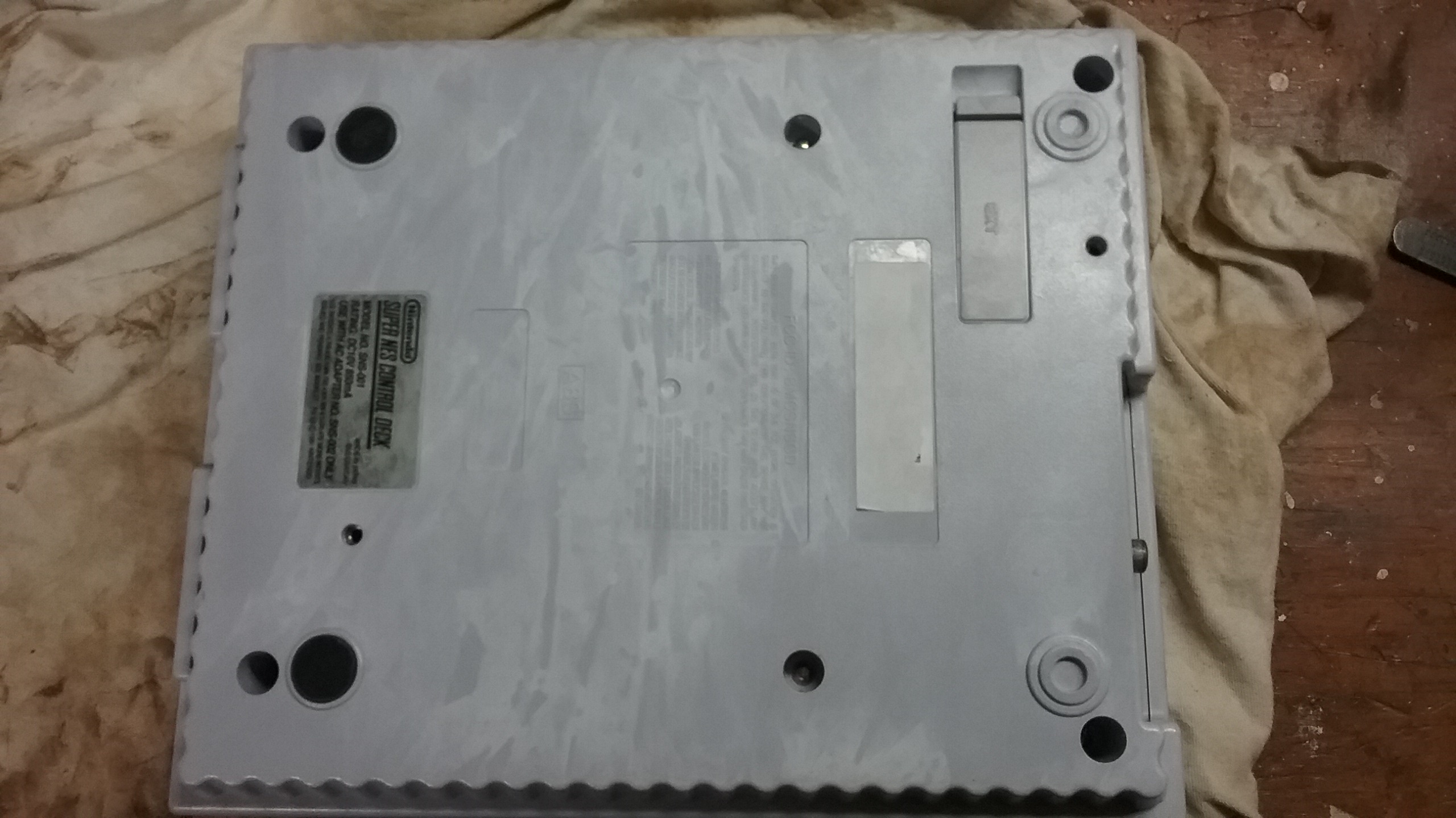

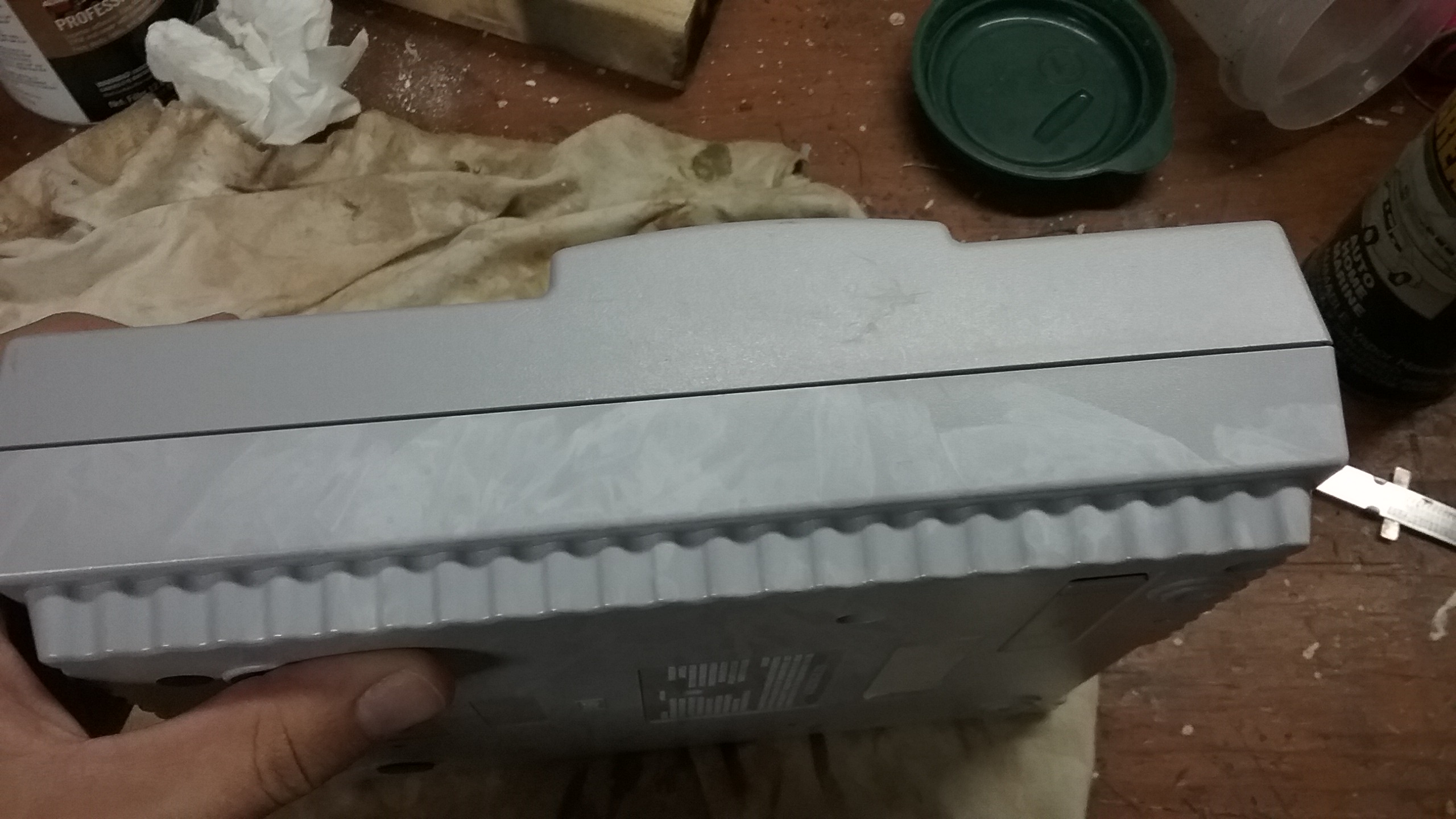

    Last weekend I decided to de-yellow my SNES, which was a tad yellowed on the bottom. I used the method shown in The 8-Bit Guy's video, using volume 40 cream. The first day did little to the shell, but that was my fault because it was a bit cloudy that day and I had it in a shady spot. The second day was really sunny and I had it in a place where it would get plenty of sun (the roof ;)). When I took it down, I noticed a bunch of white splotches. I tried washing them off but they wouldn't come off.
    These white splotches are very annoying, and if anyone knows how to get rid of them, PLEASE let me know. At this point I almost wanna buy another SNES and custom paint this to hide my dire mistake. Also will the original method found here not get those spots?

    I'm no chemist, but that might've been the peroxide eating into the plastic - it's nasty stuff. And you even sourced some at 40%? Hot damn! Notice how the two original recipes only use 30 and 6%, respectively... Anyways, now that it's already happened, maybe try some light sanding? Even if it doesn't get rid of the splotches, at least you'll have a decent base for a paintjob...

    Volume 40 cream =/= 40% hydrogen peroxide.
    To the OP, try smoother application of the cream and better Saran wrap covering.

    That shell is gone, sorry.
    I recommend you do SNES shells only with full submersion methods.
    The wrap method is what caused this.

    Yeah, you can see the lines and bubbles from the wrap.
    However, if you fully submerge, you will be able to fix it and get it all an even colour if you leave it under a decent lamp, but the plastic will be brittle as hell after that and probably bone white.
