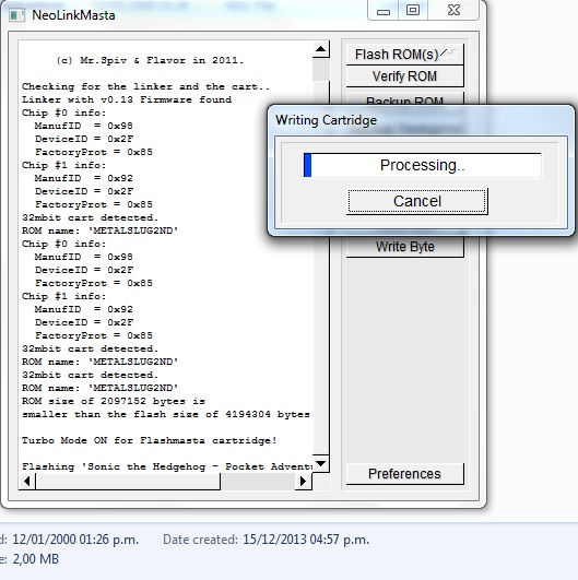

    This unit has been created to connect Neo Geo Pocket cartridges and modern PCs via USB; therefore, first of all you have to connect the Linkmasta and the pc with the USB cable and then insert the Neo Geo Pocket cartridge, Neo Geo Pocket Color cartridge or Flashmasta in the Linkmasta unit. In the computer, use the software to do something like:
    -Back upping game save data.
    -Restoring previous game/emulator backup save.
    -Recording a rom onto a recordable cartridge (you have to use Bung, Mr. Flash, UFO, etc, to do so) or flash cartridges such as the Flashmasta.
    - Back upping cartridge data; in other words, creating a rom from a cartridge (this is useful when trying to play a game that you have in an emulator) and more!!

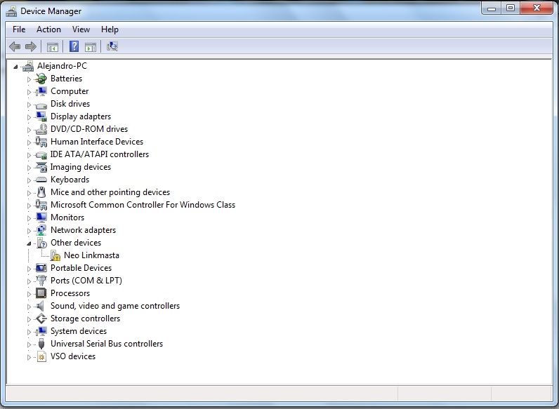

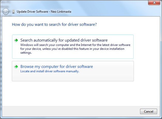

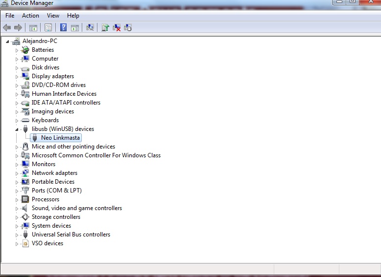

    1-Download the “libusb” controller and save the file in your computer’s desktop.
    2-Minimize all windows, so you can have a clear view of your desktop. Right click on the “libusb driver Win – Neo Linkmasta PID_4178.zip” file and select “Extract all”. The program should ask you where do you want to store the extracted files, so you have to click on “Examine”, then on “desktop”, then on “Accept” and then click on “Extract”.
    3-If you have not plugged the Linkmasta yet, you can do it now. A box might pop up automatically requesting for the drivers, if not (or if the devices has been connected previously), you might need to use the Windows device manager; In short, this step focuses on allowing windows to locate the controller that you just downloaded and decompressed.
    In the device manager you have to look for the "Neo Linkmasta", right click on it and select “Properties”. In the “Controller” tab you should find a button that says “update controller”, after clicking on that button you should select “Look for controller software”, then a little box that says “look for controller software in this location” must pop up. Click on the “Examine” button, look for the option that says “libusb driver Win – Neo Linkmasta”, then click on “accept” and this is going to auto-populate in the box:
    " C: \ Users \ erm \ Desktop \ libusb controlador Win - Neo Linkmasta"
    Check the box that says “Include subfolders”
    Do not check the box that says “choose from a list of devices”
    Click on “Next” and follow the instructions to complete the controller installation.
    Now you should be ready to use the Neo Linkmasta program to read/write your Flashmasta cartridge.
