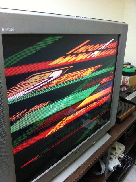

    EDIT2: Result so far... need to fix something here... not sure what's wrong:
    EDIT 3:
    Added 100nF ceramic caps on the R G B line.
    Got a little bit of progresss here:

    Guys just wanted to bump this tread to comment that I actually made it work :))
    I finally got RGB on the laseractive.
