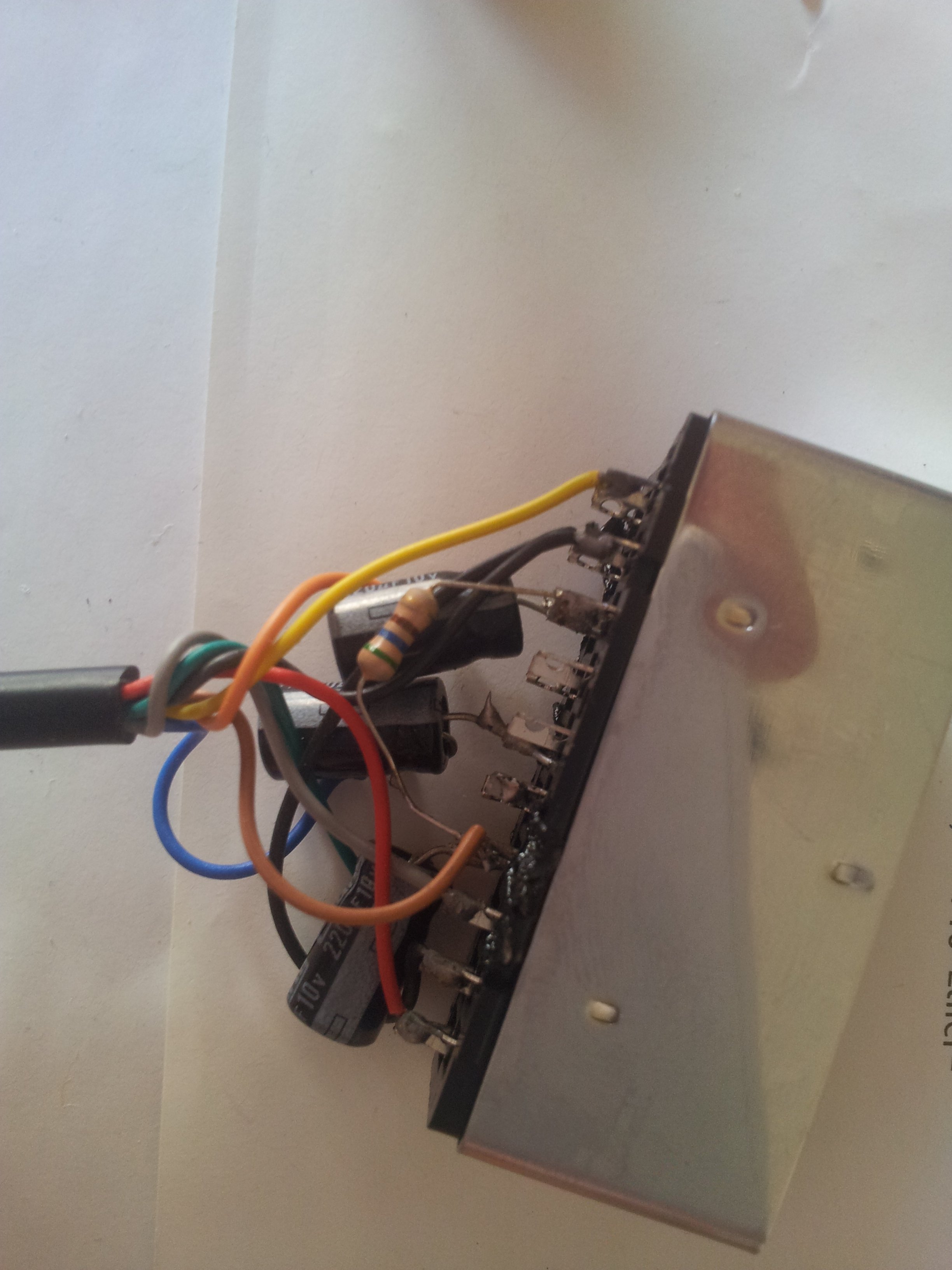

    ive lost my compositive cable that come with the dc (the one with yellow red white cables) I buy an rgb scart ive test it in two tvs one is old fashion tv. the screen comes the colors are correct but they are dark on both tvs. ihave also clean all the contacts. now about dc the socket that av is pluged have two plasticks one on the left side and one on the right. same goes for the serial socket. but in the av socket are both broken could this be a the problem?? also I try when the dc is open to move the conector but nothing change.

    How dark are they? Are there resistors in the scart plug part of the cable? If so, what are the values?

    this is only resistor 554om the brown cable that goes to the resistor leg is the 12v one ive also try to remove the three capasitors but the result is the same I can see colors but are black very black
