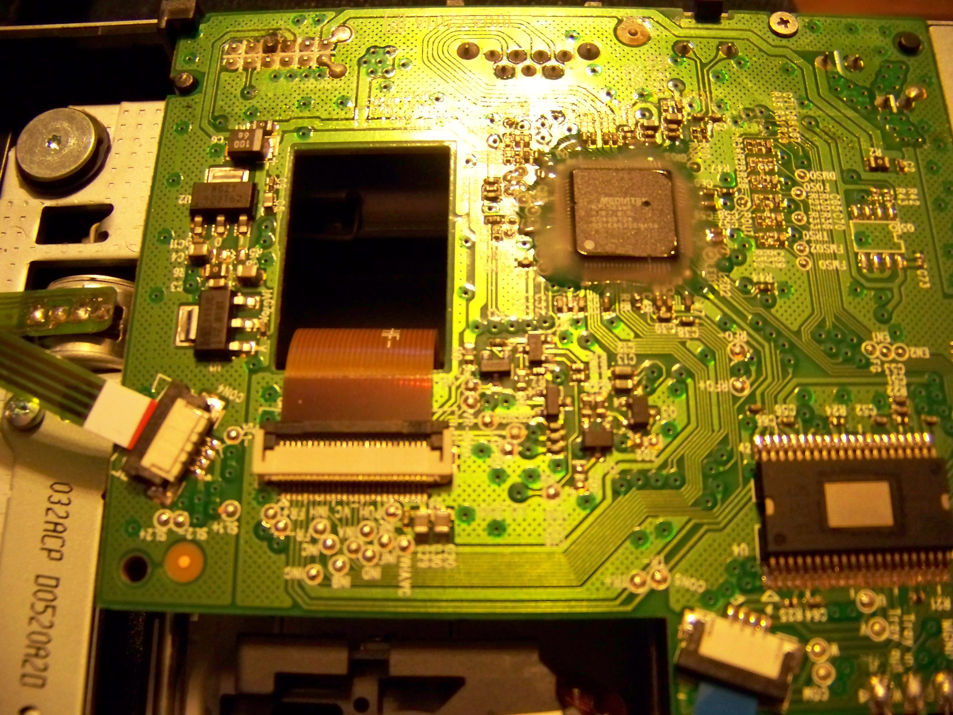

    I took apart the drive and cleaned the laser with a Q-tip and alcohol. The error still remains unfortunately.
    While I had it apart, I noticed a few things. There is a divot on the chip. Is that normal, or is that from a kamikaze attempt? Also near the top left it looks like some soldering might have taken place.
    I guess I'll try hooking the drive up to my PC and see what I can discover. I saw a YouTube video that said I can do a direct SATA -> PC connection as long as I use Driver Signature Enforcement Overrider.

    See if the laser is red when you try ejecting the drive...if nothing is coming from the laser its dead
    yeah it had a kamikaze hack to it..probably drilled too deep and killed the pcb..if you get a usb pro v1 and ck3i or maximus lizard you could dump the ofw from it and flash it to a new unlocked pcb. But first check to see if the dvdkey(dummy.bin) matches dvdkey in jrunner(nand)..you could also replace that mxic chip as well on the pcb to recover it.
    If that doesnt work you can create a ofw from info from your nand/cpukey in jrunner and use jungleflasher to create a new ofw or cfw to flash to a new unlocked pcb..they cost about $30-50 on ebay or even this pcb to see if it recovers.

    Would the PCB be completely dead if it was drilled too deeply or would it still kinda work?
    When I put in a 360 game disk, it spins up and through FTP or file explorer I can access the VIDEO_TS and AUDIO_TS folders.
    I'm beginning to think this might just be a bad flash job. Maybe? I don't even know. It's weird.
