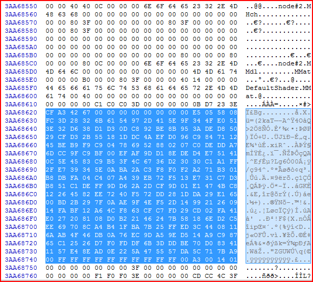

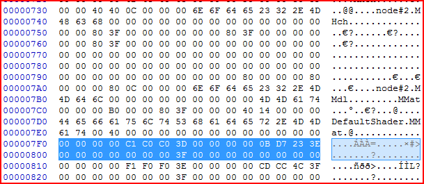

    I'm currently manually blanking the track03.bin to release to our comradEs and noticed another oddity I though it best to share.
    I was navigating to the end of SC.MIFF to find the raw data tacked on the end before the next sector/file and guess what? The end of SC.MIFF is fine extracted, but it is in WTF mode in the TRACK03.BIN
    :eek:
    EDIT: I redid the pics. You can see in SC.MIFF the two lines hilighted. In TRACK03.BIN in between these lines some weirdness has been injected in there.

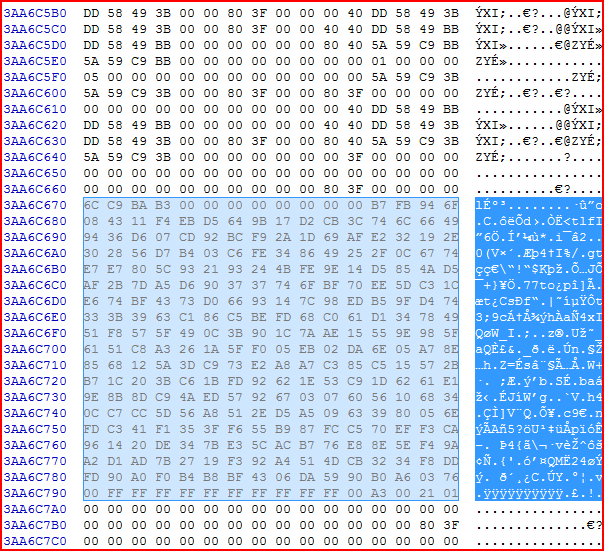

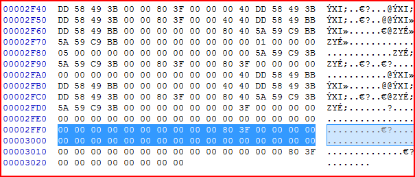

    VOLUMES.MIFF WTF!
    Same deal as SC.MIFF, VOLUMES.MIFF has code injected inside it in TRACK03.BIN near the end of the file / before the raw data. Still zeroing atm not got time to ponder why they do it yet, I'm sure by the time I zerod someone will have informed me :p But they could be like tacs etc.

    You seem to be comparing a data-only dump (2048) to a raw dump (2352). Those extra bytes in the 2nd pics are the ecc and sector sync header.
