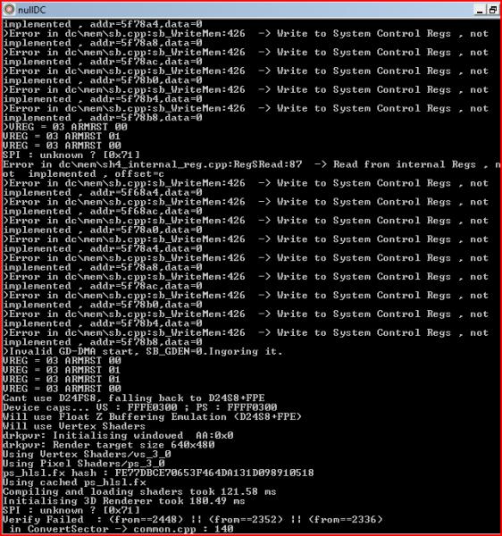

    I tried ripping HDR-008 Geist Force with different Padus DiscJuggler settings to see if they had any effect on the nullDC errors. The list is not extensive as I tested other variations I neglected to add, but basically the only thing that made any difference was setting PQ to on - and correct me if I am wrong but even then it should only affect subchannel data which AFAIK the Dreamcast doesn't use.
    Scan Gaps Ignore Errors PQ RAW DAE Jitter nullDC Error
    0 0 0 0 Native Verify Failed : area--SingleDensity in cdi_DriveGetTocInfo -> cdi.cpp : 231
    0 0 0 0 Overlap Verify Failed : area--SingleDensity in cdi_DriveGetTocInfo -> cdi.cpp : 231
    0 0 0 0 Redundant Verify Failed : area--SingleDensity in cdi_DriveGetTocInfo -> cdi.cpp : 231
    0 0 0 1 Native Verify Failed : area--SingleDensity in cdi_DriveGetTocInfo -> cdi.cpp : 231
    0 0 1 0 Native Verify Failed : <from==2448> ¦¦ <from==2336> in ConvertSector -> common.cpp : 140
    0 1 0 0 Native Verify Failed : area--SingleDensity in cdi_DriveGetTocInfo -> cdi.cpp : 231
    1 0 0 0 Native Verify Failed : area--SingleDensity in cdi_DriveGetTocInfo -> cdi.cpp : 231
    Given as the hexa codes keep bullshitting between different styles, on the main crash I noticed one of the possible hex values is spookily representative of the Data1.iso file size (from a certain point of view, probebly a coincidence). Removing 150 bytes as FG suggested earlier though only served to make the image file invalid, which meant Daemon tools wouldn't mount the .NRG which in turn meant there was no way in hell Padus DiscJuggler was going to .CDI it!
    I suspect the usefulness of the PQ error log will be somewhat limited but I have included it regardless.
    I'm hoping ASSEMbler can dump some SYSTEM-DISC 2, HKT-06 GD-R and SYSTEM-DISC 2 + HKT-06 GD-R syscalls later too - they will possibly be like looking for a needle in a haystack as there is likely to be little variation between files but I'm hoping if they do not provide greater insight into a specific problem they my provide some enlightenment of the broader picture of the disc access function.
    Sadly between doing mostly labourious testing I haven't had the chance to try anything exciting today. It doesn't help that I am incredibly tired so I am working slowly. I've had to delete and merge some posts and reprimand as well as ban users too which ll takes time. I'll be away for the weekend but hopefully on my return on Sunday evening I'll be refreshed with new ideas and new suggestions and help move the project along... well that is only if you lot don't beat me too it :D

    In the log somewhere, it says there's an unknown Sega Packet Interface (SPI) command: 0x71 (also called 71h for 71 in HEX)
    Command 71h isn't defined in the docs I have on the SPI. Also, the ATA standard, on which SPI is based) states 71h is a "retired" command. Before it was some kind of SEEK command. It was tagged obsolete in ATA3 and retired in ATA4.
    Just though it might help!

    I tried a whole bunch of games and I can get that unknown SPI code to appear in most if not all of them whether I use GDI or CDI. I wouldn't focus on that too much. You have to pause nullDC or be quick to see it as it will keep reading excerpts and bump the log, but that particular SPI error is replicable.

    This message is actually quite common in NullDC but normally won't affect gameplay. It appears even before game booting.
    Don't know if this is what makes the .nrg to boot in NullDC but locks the retail DC
