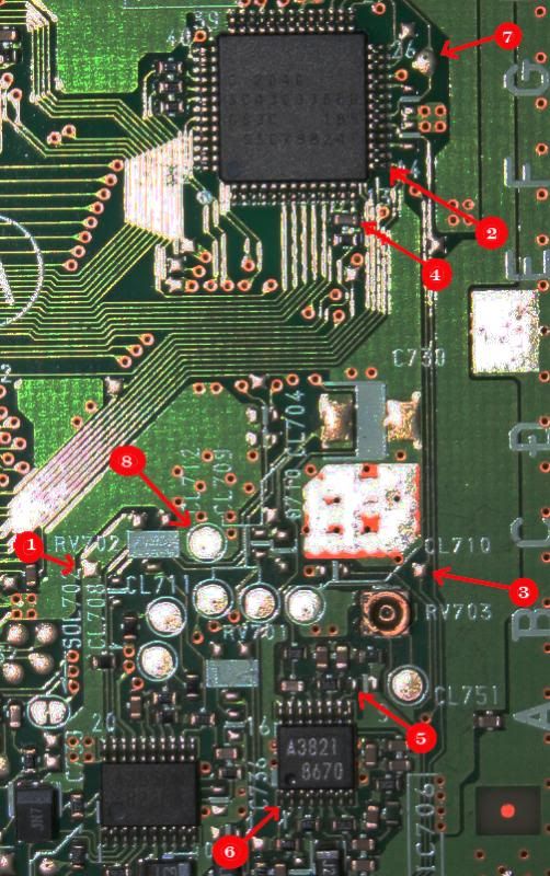

    On the original topic, I just spent 2+ hours trying to put a Mayumi V4 I got from Bad_Ad into a near-new 7001 PS1 I recently found. It all went great until I manged to bridge two legs trying to put wire 6 into place (see pic).
    Anyone who has done this particular combination of machine and mod will know that chip is freakin' tiny! Spent most of that 2 hours trying to wick solder out from under the legs - checking in between attempts with a magnifying glass - I eventually got it with my rarely used solder pump - tacked the wire back in place and - success! Then I discovered that where I had glued the chip to the board was exactly in line with two of those weird raised holes on the heavy metal shield between the board and the laser assembly - had to drill them out to get the stupid thing back together. Doing a PSone on the weekend - hopefully it will go a little smoother.

  7. MaxWar
    Aug 13, 2012
    1,486
    Wick usually works great for bridged legs, the trick is to use flux. Without flux, wick barely even works.

  9. -=FamilyGuy=-
    Mar 3, 2007
    3,034
    891
    Yeah, use flux but don't forget to clean toroughly afterwards with methanol or another flux solvent.
  10. synrgy87
    synrgy87 Well Known Member
    Jul 12, 2012
    1,769
    this, but there are some wicks out there that seam to be cheap and nasty and dont pick up the solder very well to start with, flux helps in this regard

  12. MaxWar
    Aug 13, 2012
    1,486
    I always use flux with my wick and it sucks in turbo mode.
    Without flux it sort of works at best. And not at all at worst. I doubt any braid will work as well without flux than with it.
    The brand of wick that is available here is MG chemicals.
    Maybe its not the best, but its not very expensive and I use it with MG chemicals Rosin flux, which is dirt cheap.
    I bought a bottle years ago which was about 250 ml, I diluted to 500 ml with methanol and it works just as well ( better actually ).
    I put the stuff in a blunted syringe.
  13. -=FamilyGuy=-
    Mar 3, 2007
    3,034
    891
    Ofc if there's already enough good flux you don't need to add some. I use braids taht have no flux at all (for some completely logical reasons) and when I need to desolder stuff using them, I gotta add some flux otherwise it's not really effective.
