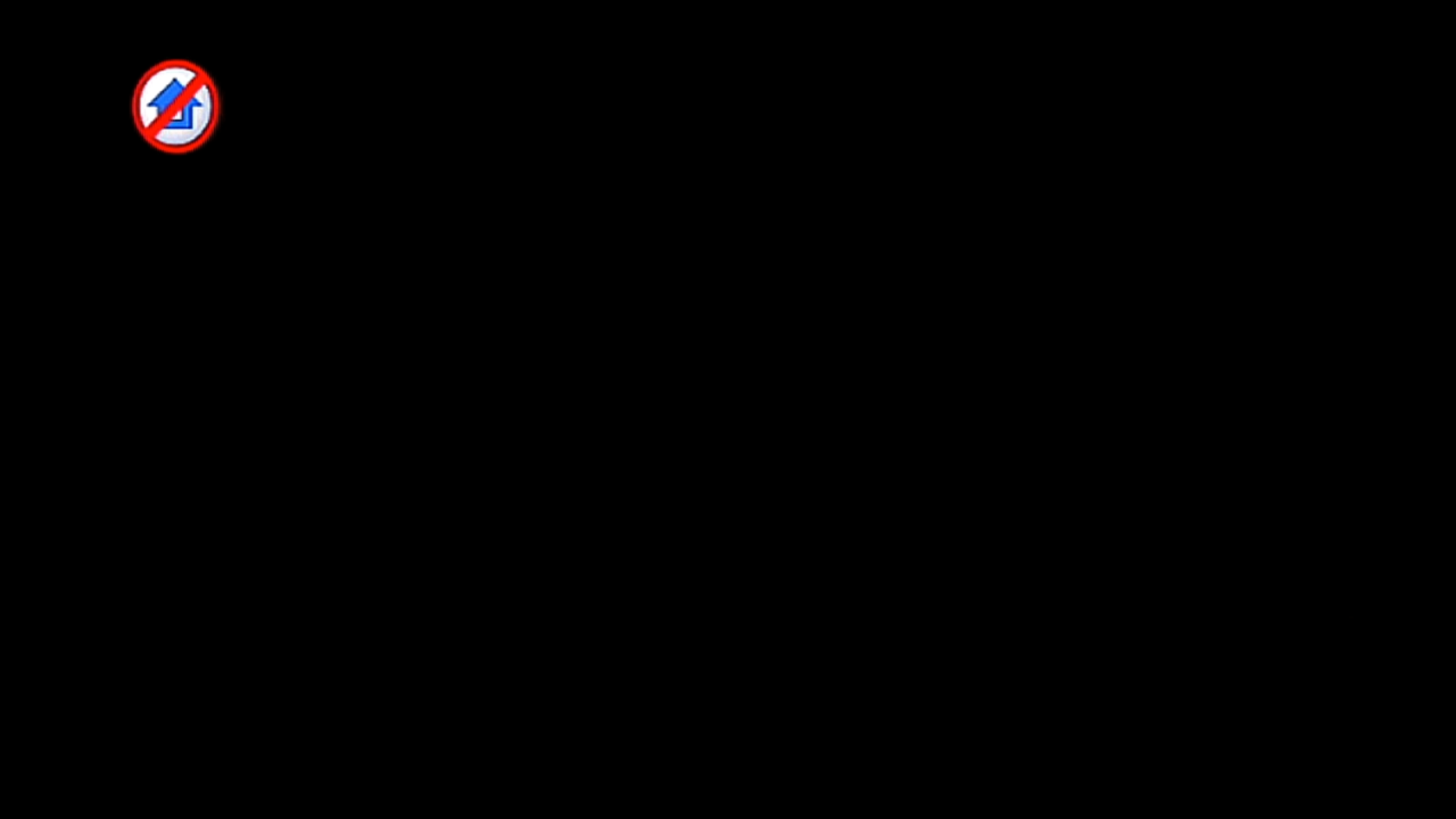

    Just as the game froze I pressed the Home button. This is what it looked like right before I shut it off.
    I'm gonna leave it to cool off for about 24 hours and see if that fixes it. Some people who have experienced the "Black Screen of Death" have reported that unplugging it, waiting, and then replugging it fixes it. I have no idea if this will work for me though.

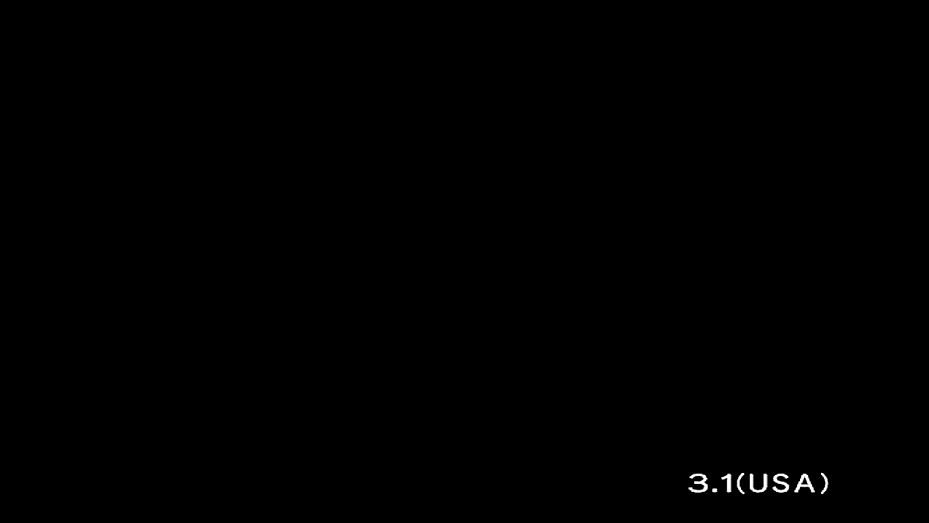

    Update:
    I tried the Gamecube controller method and it worked! I'm beginning to suspect more and more that the problem really is being caused by a broken Bluetooth module. The black screen, no sound, something halting it from booting properly, the fact that it crashed just as I pressed the Home button, etc.
    I don't know if that really is the case, but I'm hoping it is. I have no idea when I'll be able to replace the module. Hopefully it'll be within the following two weeks or so.
