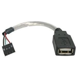

    1. The USB port otpion
    The main purpose / feature of the Satisfier is the option to connect an USB port (in the actual project, a mini-B port) in the Sega Saturn. This dream can finally becomes true with this initiative. With an USB port to make the Sega Saturn access external data, it can load games from a Storage device, and help developers to create homebrews, connecting the Saturn directly from a PC.
    The main question is "How the USB port can be featured?".
    Using the USB port connected (soldered) directly to the board is the initial and most logical idea. But how about change it a little, replacing the USB port with a "wire to board connector", and connecting the USB port from this connector?
    This option have some good points and considerable benefits. To start, would be possible to create a shorter board, instead of a long board just to make an USB port accessible. The wire to board connector can be installed in the upper part of the Satisfier board, and just connect the cable.
    The second benefit is, in the case of an USB port connected directly into the board, it will save the board of the possibility to broke the solders of the USB port with constants pluging and unpluging during time. If, by some way, the USB port got damaged and not work anymore, you don't need discart all the board or make the work of re-solder the USB port again. Just replace the USB port, unpluging the cable from the board and replacing it for a new one.
    The third benefit is a custom Saturn's back door with an USB port build in can be factured, saving the users to mod the shell of their Sega Saturn to have a permanent USB port installed on it... without counting the fact the Saturn users who lost their console's back doors and have plans to get a Satisfier will have a good replacement for it.
    You can even find 3D PROJECTS to create the SATURN'S BACK DOOR IN A 3D PRINTER. So, it's just the matter of modify the project to add an USB port.
    The final benefit I can list here is the USB port can be easily replaced with another type of port for the taste of each user, like replacing the USB port for a SD Card port (so, the Caveat point "No SD card support" can be reconsidered), or other types of USB ports, like an USB-printer port, or even an Ethernet port...
