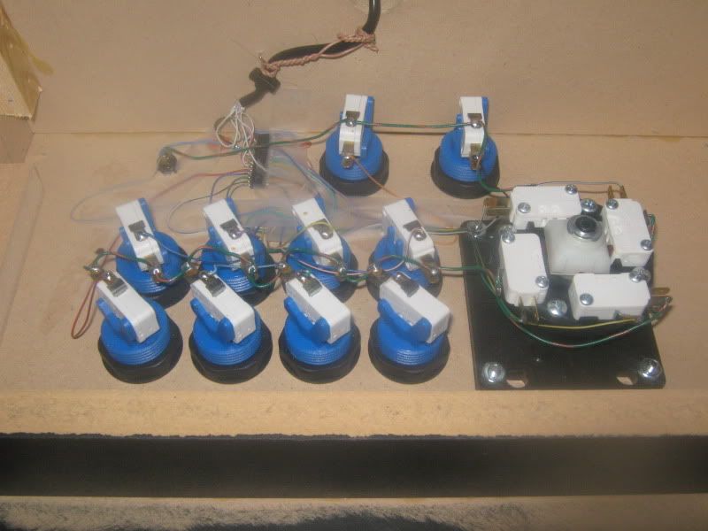

    Can you take a pic on how its inside? if you have some soldering skills i can give some directions on what to do.
  11. GodofHardcore
    Mar 31, 2007

    Ah, you have plenty of space to fit a Saturn Pad board inside and wire everything.
    You need to solder some wires to the points in the Saturn controller like this:
    (Dont mind the marks I made, was trying to figure out the turbo switchs XP)
    One wire for each button, and one for the ground.
    Them you solder to the buttons on the arcade stick and daisychain the ground betwen them.
    [​IMG].
    If its not very clear, I can make a more indeep vid tomorrow

    Might be a good idea I have a disposeible saturn controller I can use anyway (the Original US pad)
