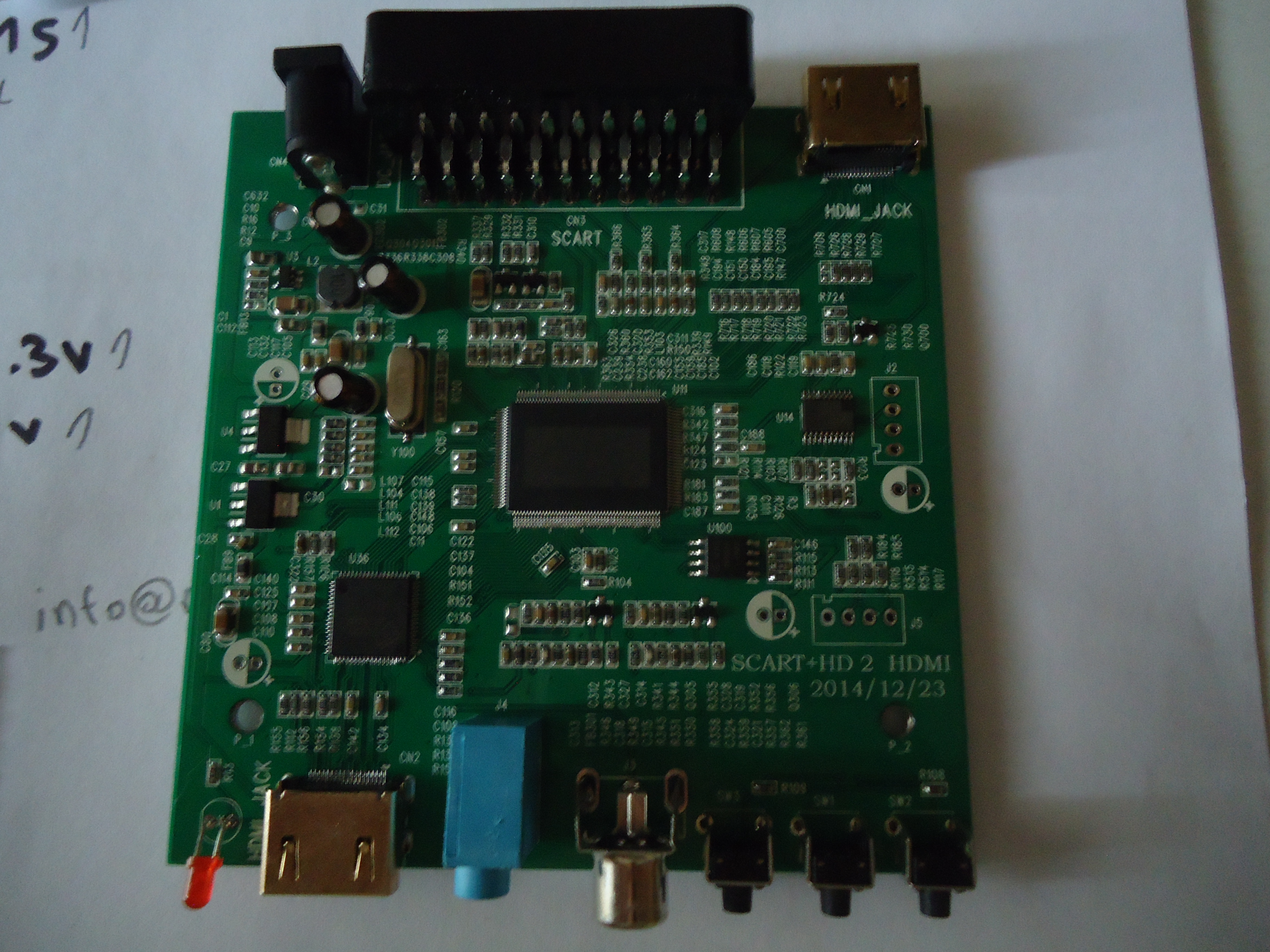

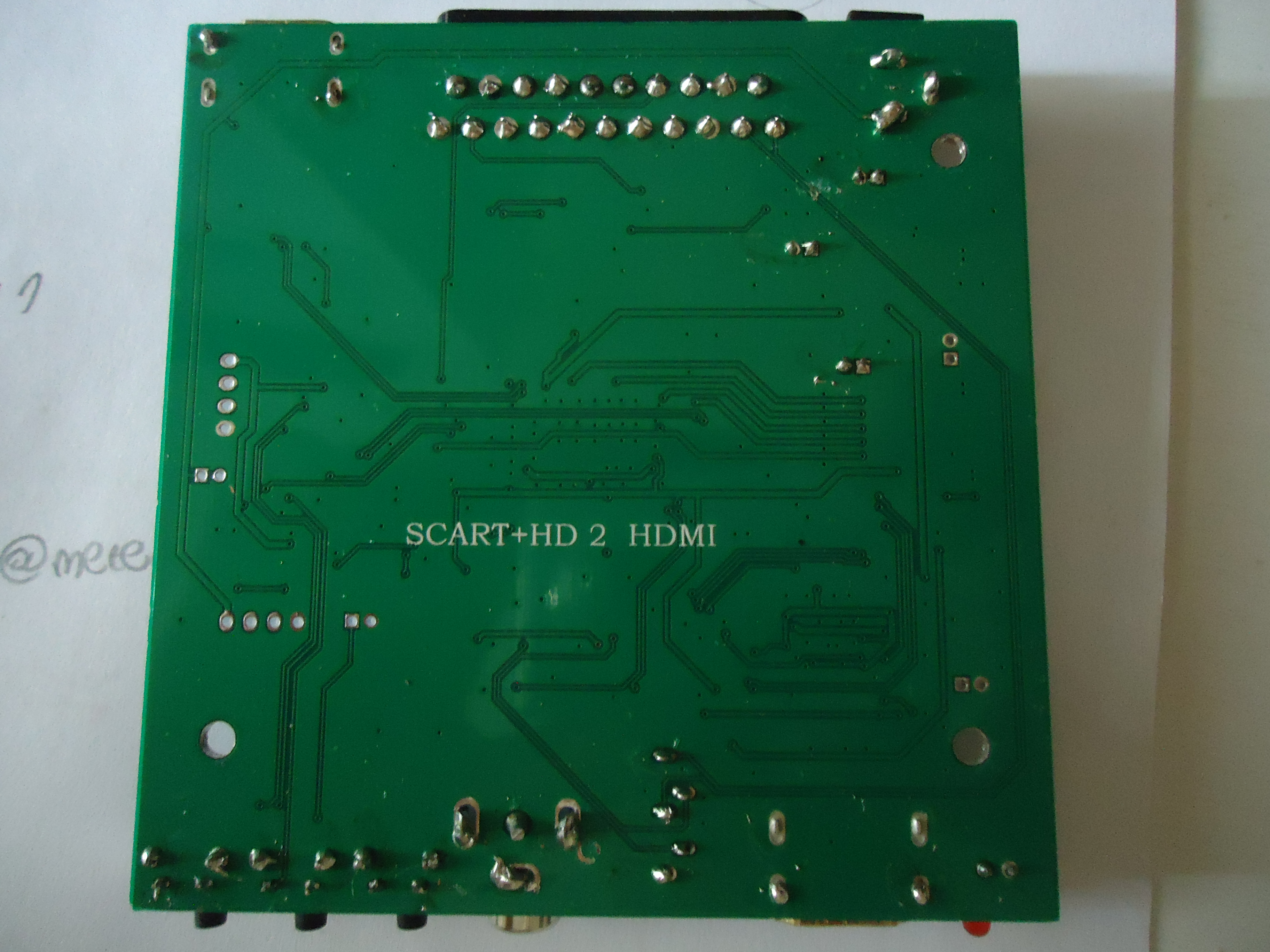

  5. snobgamergr
    snobgamergr Spirited Member
    Aug 29, 2015
    Some high-res photos of the upscaler board.
    I already tried to re-solder some suspicious looking pads,although the "no signal" issue remains.
    By the way, the lack of markings on the big black chip is kinda suspicious to me..
  6. rama
    rama Gutsy Member
    Dec 17, 2015
    477
    112
    I can't tell much from the pictures. The scratched off markings on the IC is typical. Manufacturers do this to obscure what IC it is.
    The backside shows one connector with a really lousy soldering job. You should fix that up.
  7. snobgamergr
    Aug 29, 2015
    I fixed that the moment I opened up the upscaler.
