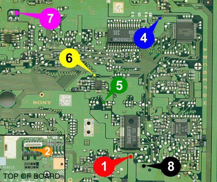

  6. Zolona
    Zolona Member
    Apr 26, 2016
    A bit late, I know, but still:
    I tried with a Stealth 2.8a and it didn't work. So I checked all connections a few times, still nothing. I flashed another chip (on my K150) - nothing. Legit games still work fine, with burned images it sound as if the laser just hits the disk a few times and then it gives up. I even checked the bias and gain too.
    Maybe the diagram is wrong? This is the diagram I used:
    Please help!
    Thanks..
  7. Bad_Ad84
    1,309
  8. Zolona
    Zolona Member
    Apr 26, 2016
    Those look exactly the same to me. If it's not the diagram and the connections are all good (I checked so many times - I can still hear the beeping) I must have made a mistake while flashing the chip(s). Or could it be something else entirely? Hmm.

  9. Bad_Ad84
    1,309
    Some people reported issues with the k150.
