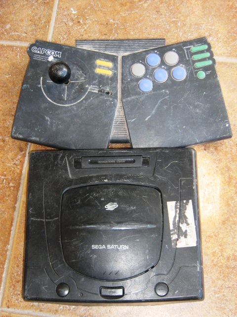

    So, any advice on how to improve the looks on consoles covered in scratches?
    I have an old Megadrive with more than a few scratches, and a couple of DCs (inc. a Sports) with some scratches on the lid.
    I've heard of people using car wax to restore or fill in the cracks in the consoles' body or for screens on portable consoles.
    An example of what I am talking about, a guy I know has recently acquired these:
    Is it possible to get that back to a nicer state? :shrug:
  2. Alchy
    Alchy Illustrious Member
    Apr 6, 2004
    6,216
    Does that Saturn even work? Where did it come from, a sawmill?
  3. ASSEMbler
    Mr. Clean magic eraser will clean that up like nothing you've ever seen.

    Yeah I believe it works, well this guy usually finds stuff in the trash or pawn shops.
    I forgot to mention, I was looking for products that might be available anywhere and not just specific brands or products as that one, but that's a good tip as to where to start.
    I have a few consoles for sale on Mercado Libre I would like to refurbish to improve their looks. Anyway they're nothing like that Saturn or CPS from the picture :banghead:

    Magic eraser = no way. It will remove the scratches but AFTER it removes the original texture of the plastic. Then again you'll never get the original texture back so go for it.
    I just wash with soap and water (after disassembly) then use a bit of Armor-all (stuff you spray on your car's dashboard) and it usually shines it like new (which dulls over time a bit) and conceals some of the scratches.
    I had a pretty damn disgusting Genesis 2 go from "UGGG!" to "pretty damn nice Gen2!" with this process.

    Thanks for the advice guys, those consoles in the first post do not belong to me, a guy I know found them in the trash in that state, they do work, but look like hell.
    I'll try this on a Megadrive I've got in very bad shape and see how it comes out.

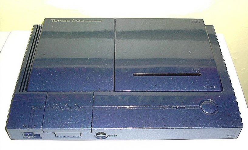

  17. ASSEMbler
    disassemble, clean in a degreaser, dry, sand, paint.
    I had a turbo duo that bad and it turned out like this.
  18. Gamer of the Ages
    Gamer of the Ages Robust Member
    Jul 2, 2010
    228
    Looks like it's made out of granite or something.
  19. Oldgamingfart
    Oldgamingfart Enthusiastic Member
    Jun 24, 2008
    509
    Yeah it looks like one of those fancy kitchen work tops. Nice effect though :thumbsup:
  20. Tchoin
    Tchoin Site Patron
    Mar 24, 2008
    2,477
    Wow now THAT looks shiny! :033:
    What's the "sand" part of the process about?
