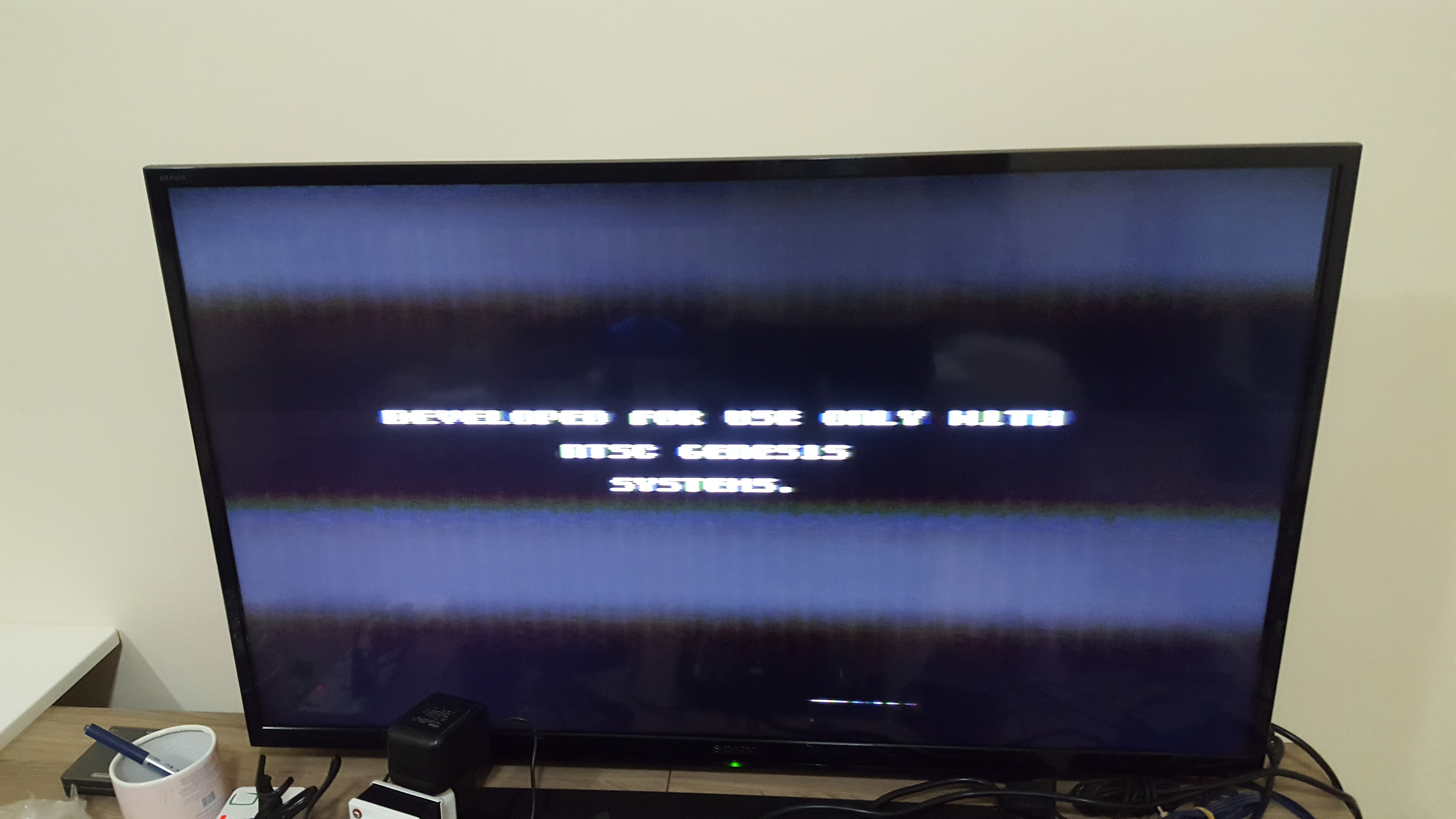

    I am experiencing scrolling what bars on multiple Mega Drive 2 consoles that I currently have. 3 of them.
    I have tried different AV cables but that did not resolve the issue.
    What could be the problem?
    Please see below picture.
  2. Lum
    Lum Officer at Arms
    Sep 30, 2010
    3,233
    Are you trying to use a PAL system on an NTSC TV, or anything of that sort?
    The problem seems too weird for RGB to fix but I've never heard of it before.
  3. ramiq27
    ramiq27 Spirited Member
    Dec 11, 2015
    101
    41
    My TV can switch between PAL and NTSC automatically. I even tried to switch manually to PAL. Tested on another TV but had same issue :(

  4. Bad_Ad84
    1,309
    Tried a different TV? or different type of AV connection? (RGB/Composite/RF/Svideo)
  5. ramiq27
    Dec 11, 2015
    101
    41
    Tried different TV, same problem. Tried RF. Not the same problem however the picture got much worse. Will try RGB.
  6. rama
    rama Gutsy Member
    Dec 17, 2015
    477
    112
    Can you try a different power supply for the MD?
  7. AndehX
    AndehX You got boost power!
    Apr 7, 2016
    356
    68
    Most like a power supply issue (if you havn't already tried a different one)
  8. ramiq27
    Dec 11, 2015
    101
    41

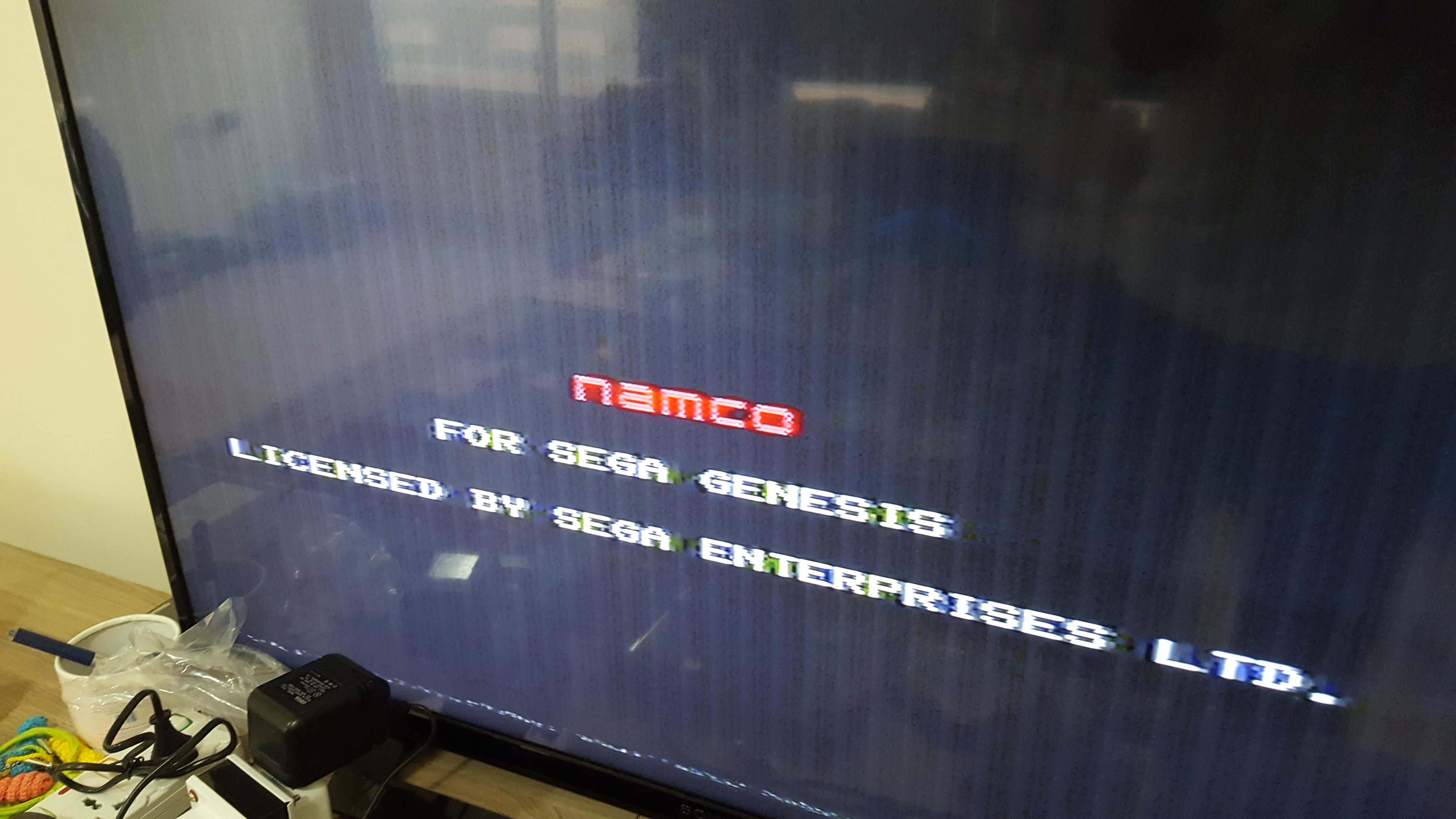

    Thanks guys. I was using an NTSC power brick on a PAL console. It completely eliminated my previous issue!
    However, I think I am experiencing jail bars now :/
    Please see picture below. I am using a universal power supply. 9V 2A.
    Could it still be a power supply issue?
  9. AndehX
    Apr 7, 2016
    356
    68
    looks like jail bars, but its normally only visable in blues. Is composite all you can use?
