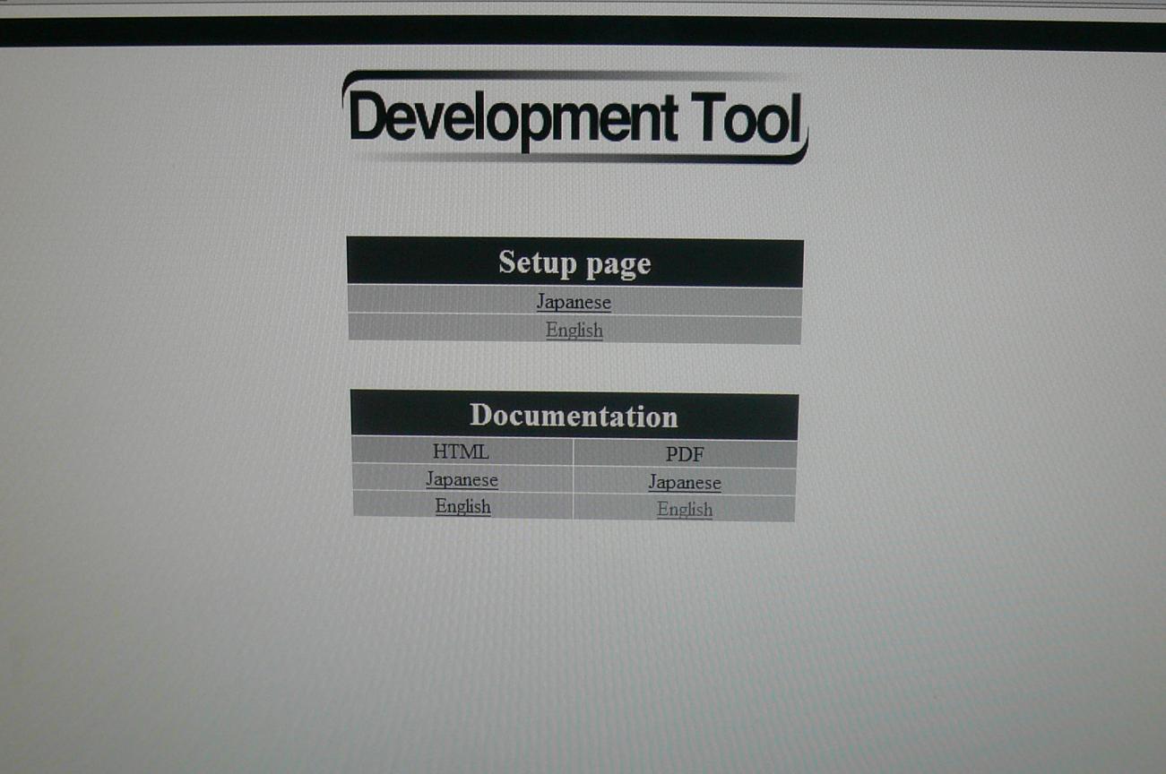

    So I was reading through some PDF files that I have of my PS2 TOOL, and discovered this secret menu on there which is accessible through your PC!!
    People may or may not no about this but I thought that i would share it anyway!!
    If there are people out there that know about this menu?? Does anyone know how to reset the Administrator password??
    This is the PDF file from inside the menu!!

    7.A password must be a mix of one-byte numerical characters, one-byte lowercase characters, and one-byte uppercase characters.
    At least two of those character types must always be used.
    Enter your password again.
    Setting and saving related messages Invalid keyword found.
    Click Back to return to the Setting/Saving screen and check what you entered.
    The keywords that you can use on the Setting/Saving screen are as follows:
    password
    mode
    hostname
    domainname
    nameserver1
    nameserver2
    ip
    subnet
    gateway
    You cannot use a keyword other than listed above. Check and see what you entered again.
    1.Keyword "mode" not set.
    You did not enter a value in the keyword "mode.
    " Enter "dhcp" or "manual" after the keyword, or delete the line that contains the keyword "mode".
    2.PlayStation2 RTC related messages
    Not supported operation
    This operation is not supported on current machine.
    Contact our service representative listed in the back cover of the Instruction Manual.
    1.An error occurred while getting the time from PlayStation2 RTC.
    A fatal error may occur in your machine.
    2.An error occurred while setting the PlayStation2 RTC.
    A fatal error may occur in your machine. Contact our service representative listed in the back cover of the Instruction Manual.
    3.Invalid year.
    Click Back to return to the PlayStation2 RTC screen and check what you entered.
    The value you entered is out of the 1900 to 2099 range. Check and see what you entered again.
    4.Invalid month.
    The value you entered is out of the 1 to 12 range. Check and see what you entered again.
    5.Invalid date.
    The value you entered is out of the 1 to 31 range or an invalid day of the month you entered.
    6.Invalid hour.
    The value you entered is out of the 0 to 23 range. Check and see what you entered again.
    7.Invalid minute.
    The value you entered is out of the 0 to 59 range. Check and see what you entered again.
    8.PC Card related messages
    1.An error occurred while getting the status of the PC Card.
    2.File IOs
    1. An error occurred while opening a file.
    2. An error occurred while loading a file.
    3. An error occurred while writing a file.
    4. An error occurred while copying a file.
    5. An error occurred while linking a file.
    An error occurred while changing a file name.
  2. SilverBull
    SilverBull Site Supporter 2010,2011,2013,2014,2015.SitePatron
    Jun 12, 2008
    385
    Quoting from "Development Tool Operating Instructions", Chapter 2: Preparation to use the unit
    To set up
    To start up Administration Tool
    After checking the setting information on your TV, start up the Administration Tool.
    1. Start up the WWW browser of your development PC.
    2. Open http://192.168.0.10/english/. The main screen of the Administration Tool appears.
    Not many, besides everyone who has ever used such a unit for daily work.
    The Tool uses an Apache server, which has its own user database. Search for htpasswd or something like that.
    [EDIT]Try this command: /usr/local/apache/bin/htpasswd /var/sony/devtool-pass Administrator[/EDIT]
    PS2Guy likes this.
