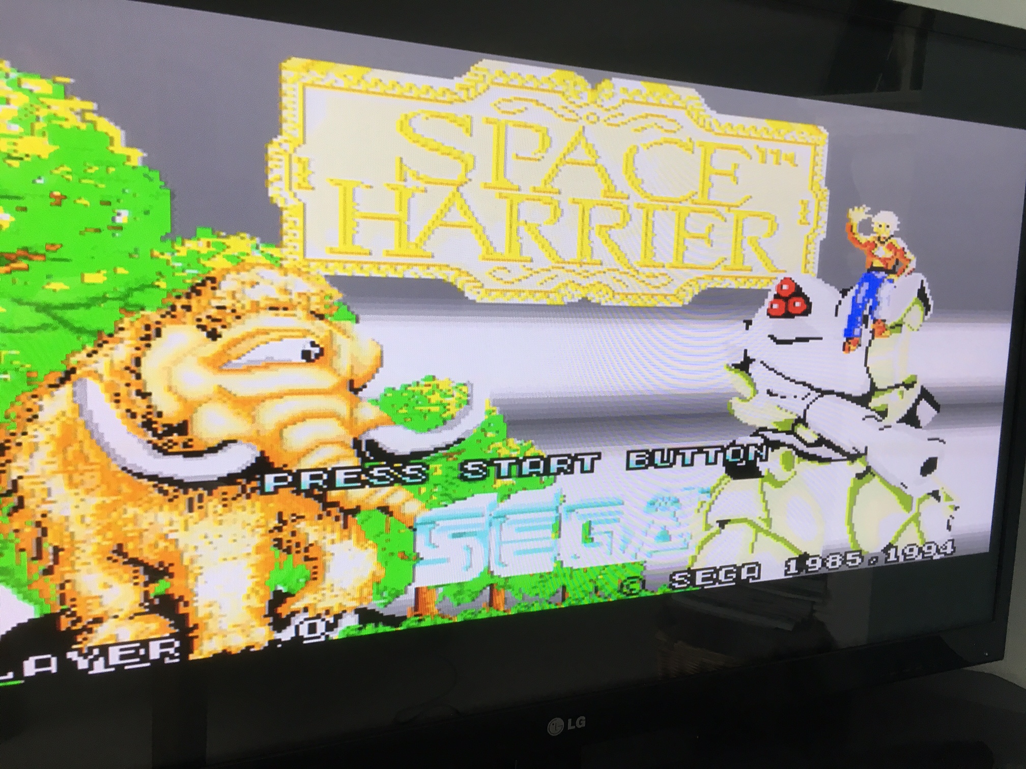

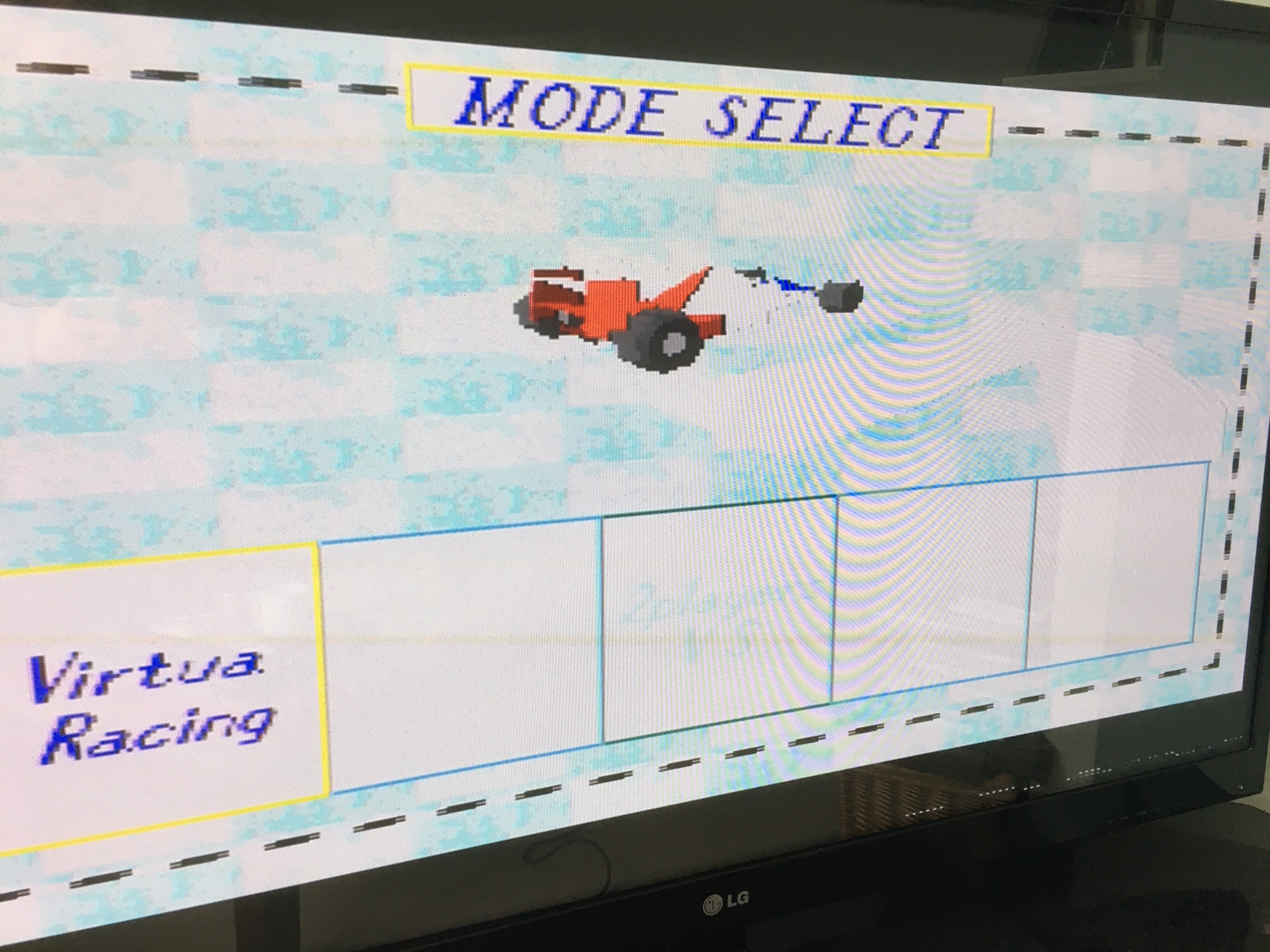

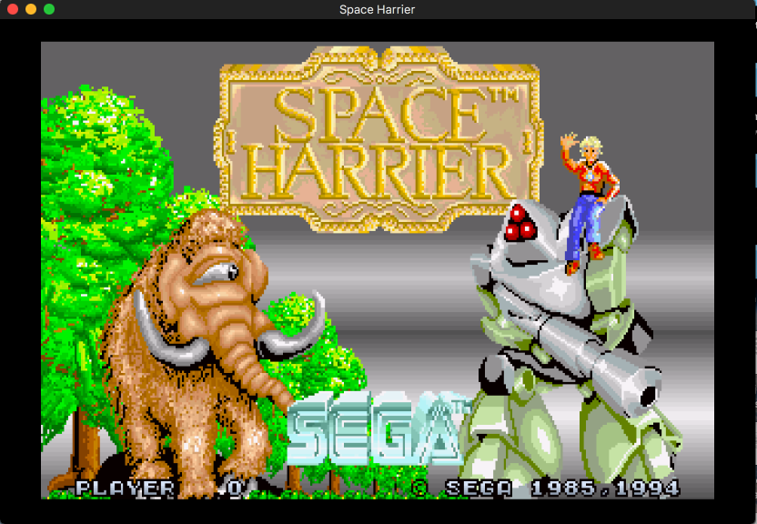

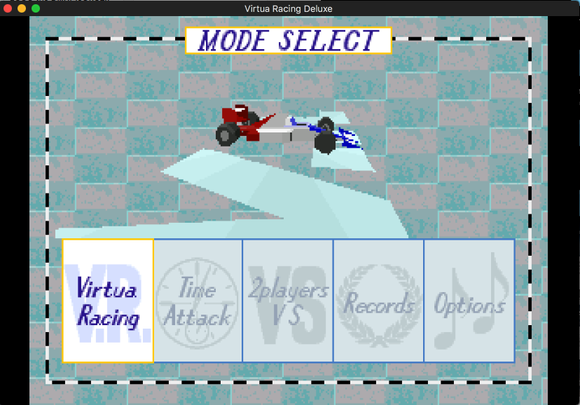

    I have just picked up a 32X console, but it looks like there is an issue with the video. If you compare my 'real life 'screenshots with the emulator screenshots below it looks like some colours are missing.
    Does anybody know what could be causing this? It could be the SCART cable but I don't have another to test.

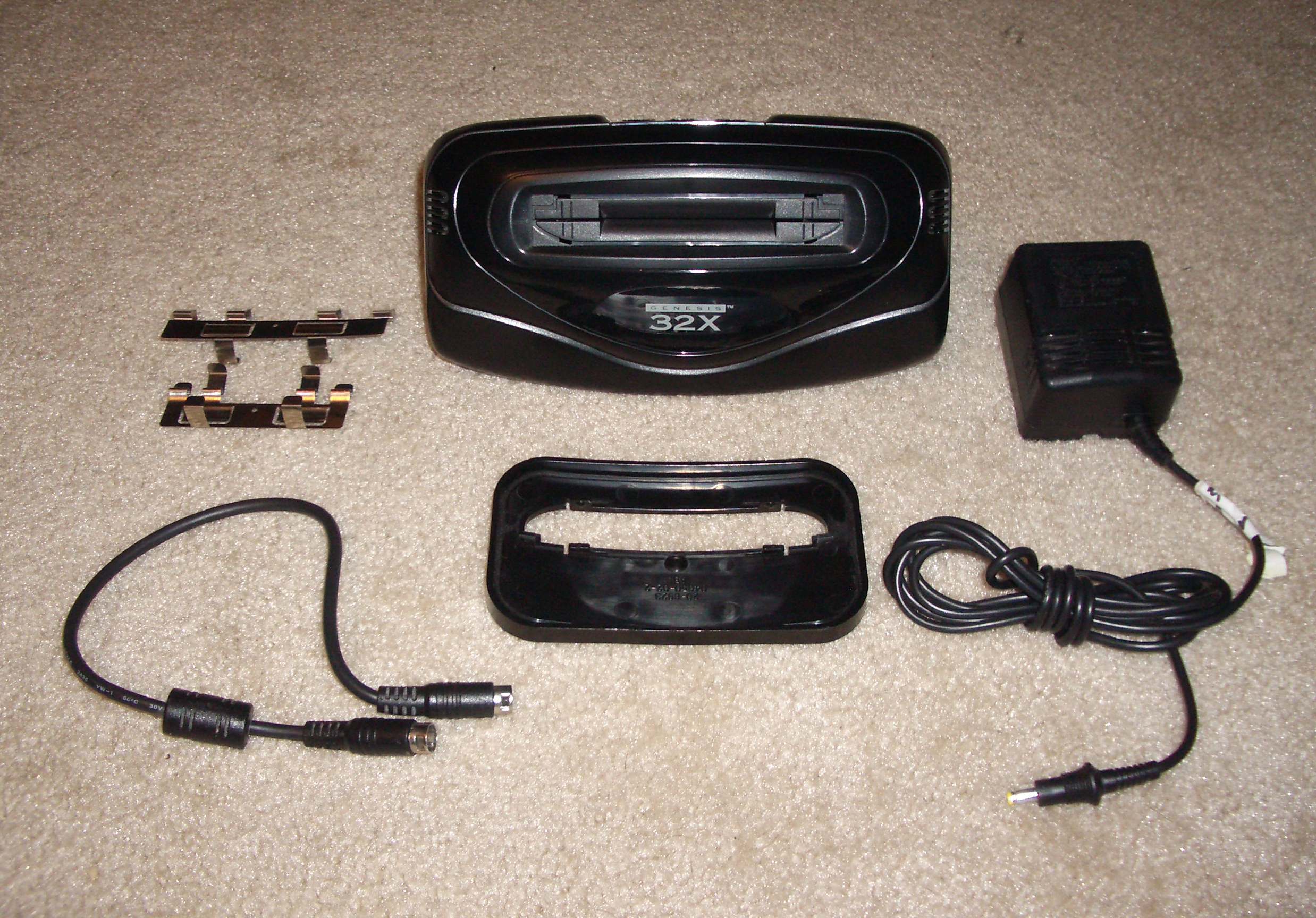

    The official Sega 32X cable has a cylinder before one of the connectors. I don't know what it's for, but most generic link cables lack it. [​IMG]
