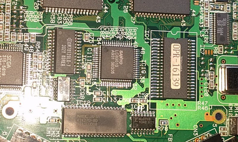

    I made a pretty cool discovery inside a CDX recently...the original EEPROM chip!
    See here for the full story.

    How does Sega-CDX BIOS V2.21.bin exist if this is a new discovery? Honest question. I was curious as to why the CDX didn't have a port of the region-free BIOS when I finally picked one up a couple weeks ago.
  3. Bad_Ad84
    1,308
    CDX does have a region free bios...
    Also ,the chip and its footprint has been known for ages. There is no drop in replacement that seem sourceable - I looked for quite some time. The MX27C1024 also comes in a SOP footprint and should match - but again, doesnt seem sourceable. You can see the drawing for the package in its datasheet.
    I dumped one with this smaller footprint from another megacd variation (wondermega? awia? i dunno, cant remember - i think it was posted on here years ago). I had a lot of work to get an adapter to fit the footprint then too. Its just not a commonly used size of chip.
    Anyway, everyone already knew the pinout matched the *1024 devices, so you just look for one of those in SOP package = chip you want. Like I said, its been known for ages.

    This hasn't been documented on the Tech wiki, I was unable to come up with the part number when I searched for it, and I found no pictures of this chip with the part number like it is in this revision.
    I'm pretty sure somebody will find the post helpful.

    Yep, it looks pretty weak. I haven't done the install myself, I've only opened up and repaired one that had a previous install. I've seen pictures of them and posts on the web over the years and it it just looks heinous. I've always wanted an actual drop-in replacement that looks legit.
    Thanks to the post I just made, hopefully people will be able to do the install more easily now that they have a datasheet and pinout of the original BIOS rom that is easily accessible and stored long-term.
    If anyone sources a good 1024 SOP eeprom for this, please feel free to share with the rest of us.

    You don't need an exact part number. The pinout is well known to match the *1024 chips as people have been modding them with the RF bios for years. This part number you have "found" also isn't the same part number of the maskrom in other consoles. Its just the one out of a long list they could have used, they were probably the cheapest at the time.
    I also dumped the non labelled version years ago and to do that that.... You need to know what type of chip it is to read it. It was common knowledge what the pinout and type of chip was, you seem hung up on a particular part number being important, which it isn't.
    The fact they have used a generic part on some odd machines will just be supply issues of the maskroms, again pretty common occurance - you can find generic eproms with part numbers in early Saturn's too. It doesn't mean that's the part number of the maskrom, it's just any compatible chip with the correct pinout.
    It will take any *1024 chip in sop format. Same as people have been using an *1024 chip in dip with wires. It only has that Toshiba part as that's what they could get their hands on. It could equally be any other *1024 chip or maskrom, it doesn't matter.
    Literally Google any *1024 datasheet will give you the same info.
    Mx27c1024
    M27c1024
    At27c1024
    Just off the top of my head. Because they are pin compatible, they are read the exact same way,just made by different companies.

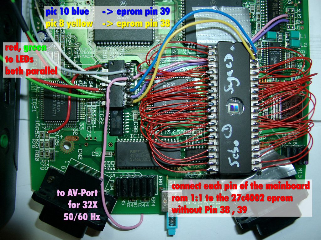

    Here is the rats nest in question. This is what Im trying to do away with (attached). I had the dubious honor of repairing this beast once. (customer was very nice though, which always makes things worthwhile).
  11. Bad_Ad84
    1,308
    This is extreme basics and something you should know if designing stuff like this.
    You can use basically any parallel eprom/eeprom/flash. The way they are read is all identical and pinout doesn't matter as you are making an adapter and can adapt it to suit.

    Bad_ad84 why is your attitude always so negative? You come into every thread that I start to spread negativity. I'd appreciate it if you would stop.
    None of this is extremely basic. It may be basic for you, but people have different levels of experience in different areas of electronics. I've never worked with programming eeproms before, so some of this is still new to me.
    I created this thread to help people in a positive way. If you want to contribute that's great. I just ask that you show a little more respect and a little less judgmentalness. We all have something to learn from each other here.
