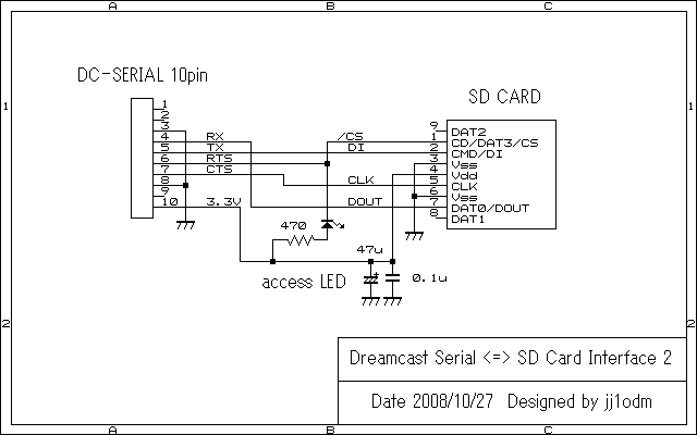

    For the sd-card adapter, I'd suggest Helder's nice little PCBs with a ribbon to put the sd-card conenctor further away on the side of the shell, very nice stuff. Check it on the marketplace.
    If you wanna do it yourself, here is the schematic:

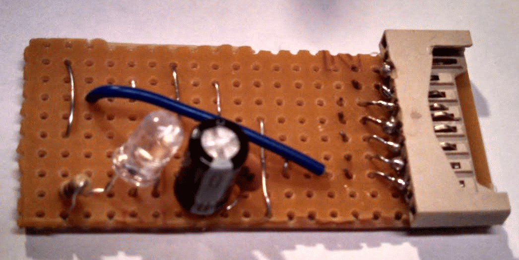

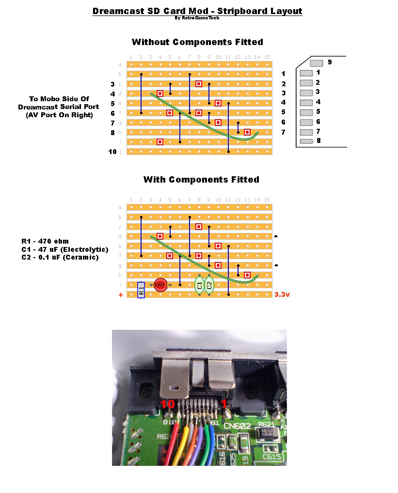

    Supplies:
    1x Electrolytic capacitor 47uF 25V
    1x Decoupling ceramic disc capacitor 0.1uF 50V
    1x Metal film resistor 470ohm 0.6W
    1x 3mm LED
    1x Stripboard
    1x SD card interface - I bought a cheap multicard reader and gutted it for parts.
    1x SD card I have 16 gb but I don't plan on putting more then a few gigs of data on it.
    courtesy of youtube.com/watch?v=qh6SxdUk_Xk
    Here is the parts placement chart for your strip board:
    dcsdstripblayout.jpg The red lines are cuts and the green (wire) and blue(resistor or whatever leg) lines show what strips need to be connected where. Here is mine 10.gif
    Software:
    http://www.dc-swat.ru/page/dreamshell/
    To boot from sd card I used
    15.08.2010
    DreamShell 4.0 Beta 4 (Form SD Loader)
    More to come!
  14. BobNewbie
    BobNewbie Rapidly Rising Member
    Jul 9, 2012
    87
    Wow, thank you for all the info! This should be just about everything I need to know.
    I've never done any modding, so I have to ask: Can you elaborate on how difficult it was?
  15. Jake585
    Jake585 Member
    Jan 7, 2016
    22
    Sure, the hardest part was the precision soldering. It really took a long time for me to get secure connections to the serial port that did not bridge. Be sure to use thin gauge wire and a fine soldering tip. One slip of the hand could potentially mess things up bad. I did the led then vga followed by the sd card mod and felt as if each mod helped to prepare me for the next. I would recommend that. Its a great idea to practice soldering first, learn to "tin" your connections and use flux. I honestly feel as if some luck was in play for me because the connections are sooo small. Lots of time and many very tiny careful steps, that's all.
