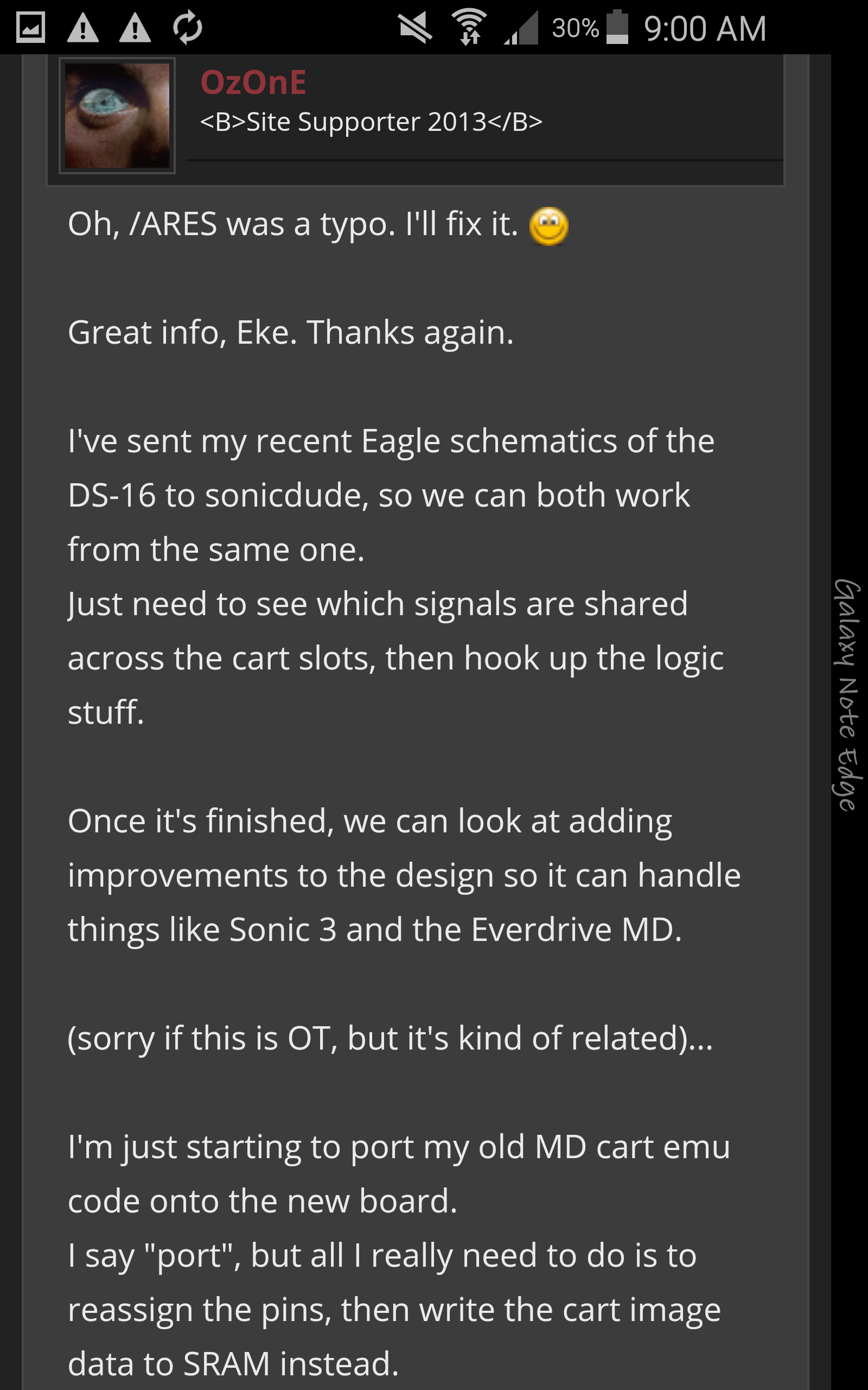

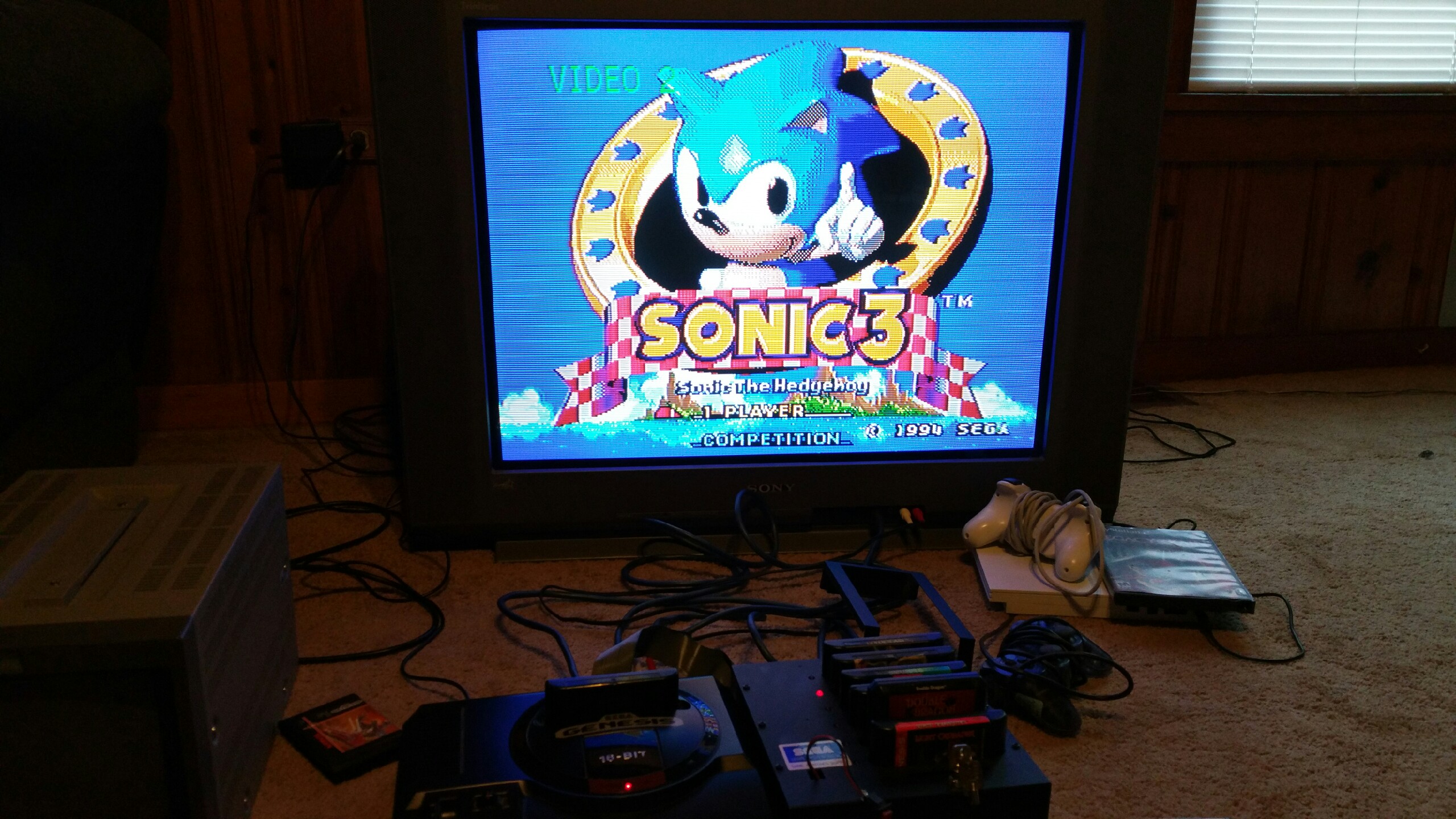

    Hello all. I've owned a couple of sega demo units before. All the documentation online and reputable Sega sites, wikis say the ds-16 is for sure not capable of playing sram equipped games like sonic 3. Like others I'm sure, I confirmed that true for myself by trying to play sonic 3 in them. I imported a new ds-16 from Italy this year and was testing it today and sure enough sonic 3 played as did all the games I had that support saves. I was really surprised. Can anyone else confirm who has a demo unit if sonic 3 plays? There is definitely misinformation floating around reputable sites.

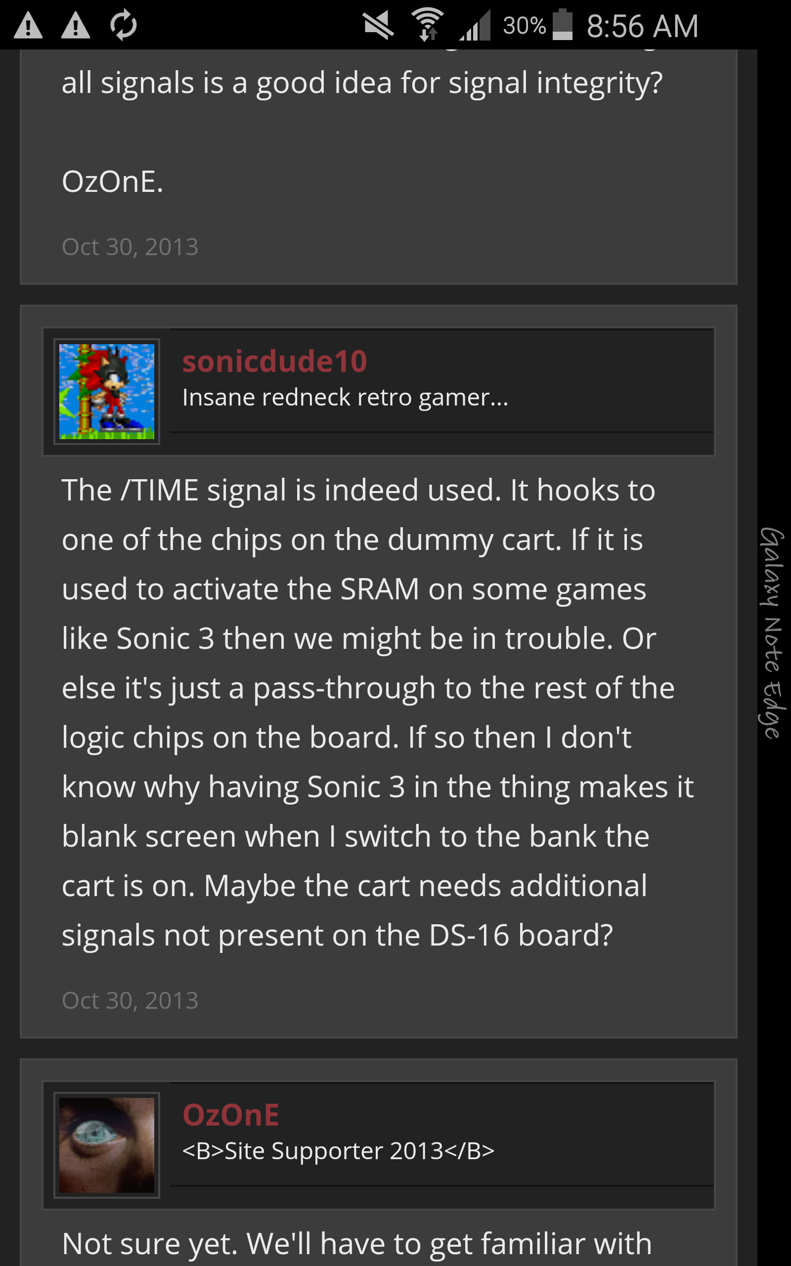

    Many reported sonic 3 as not playable on the ds-16. Theres a thread on here as well that sonic dude made trying to figure out the lines and make a schematic of it with the purpose of figuring out why sram games won't load.

    And oddly enough sonic 3 saves as well while in my ds-16.
