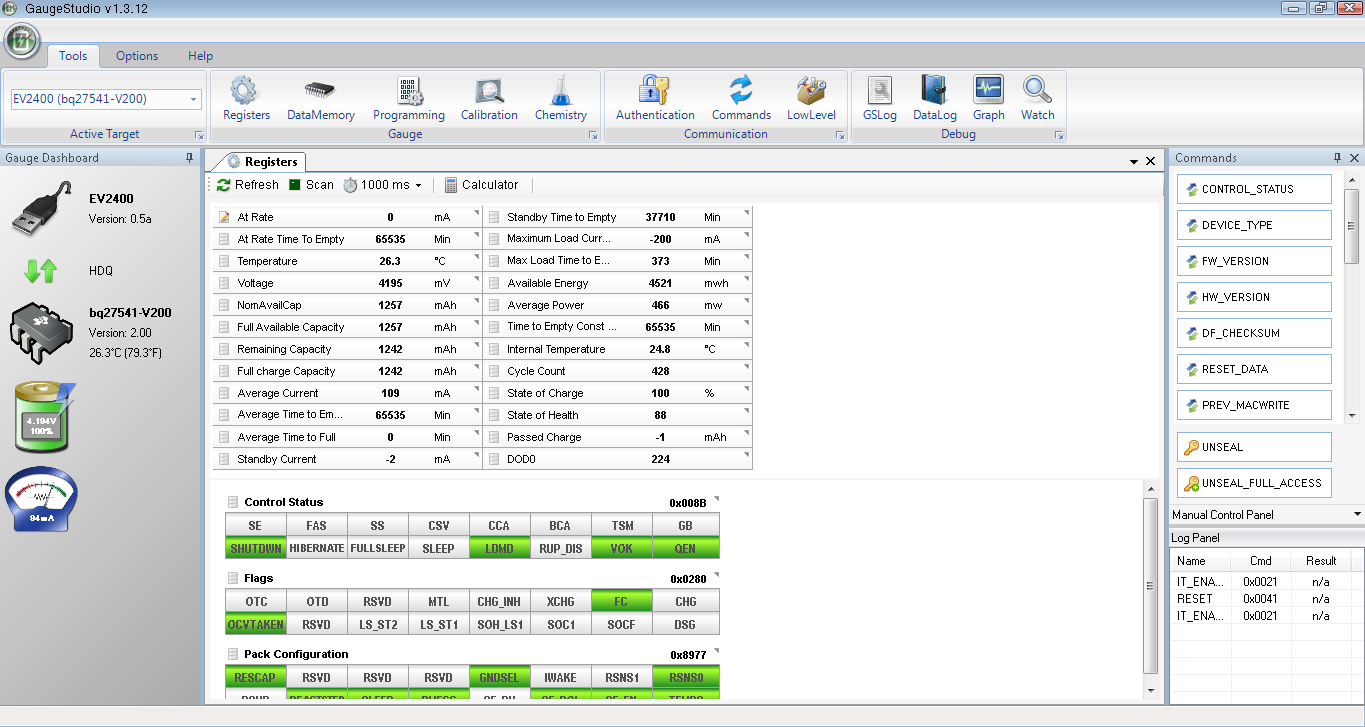

    Yeah guys, there might be one in each individual cell that cuts it off after a while, but you still need a "balance board", as they call it in the land of RC to charge it. Just like that Adafruit I posted, because balancing cells when charging is ESSENTIAL! Things like this happen if you don't! This one just had its cycle, considering it is almost 7 years old now but it is the same effect as not charging cells in balance.
