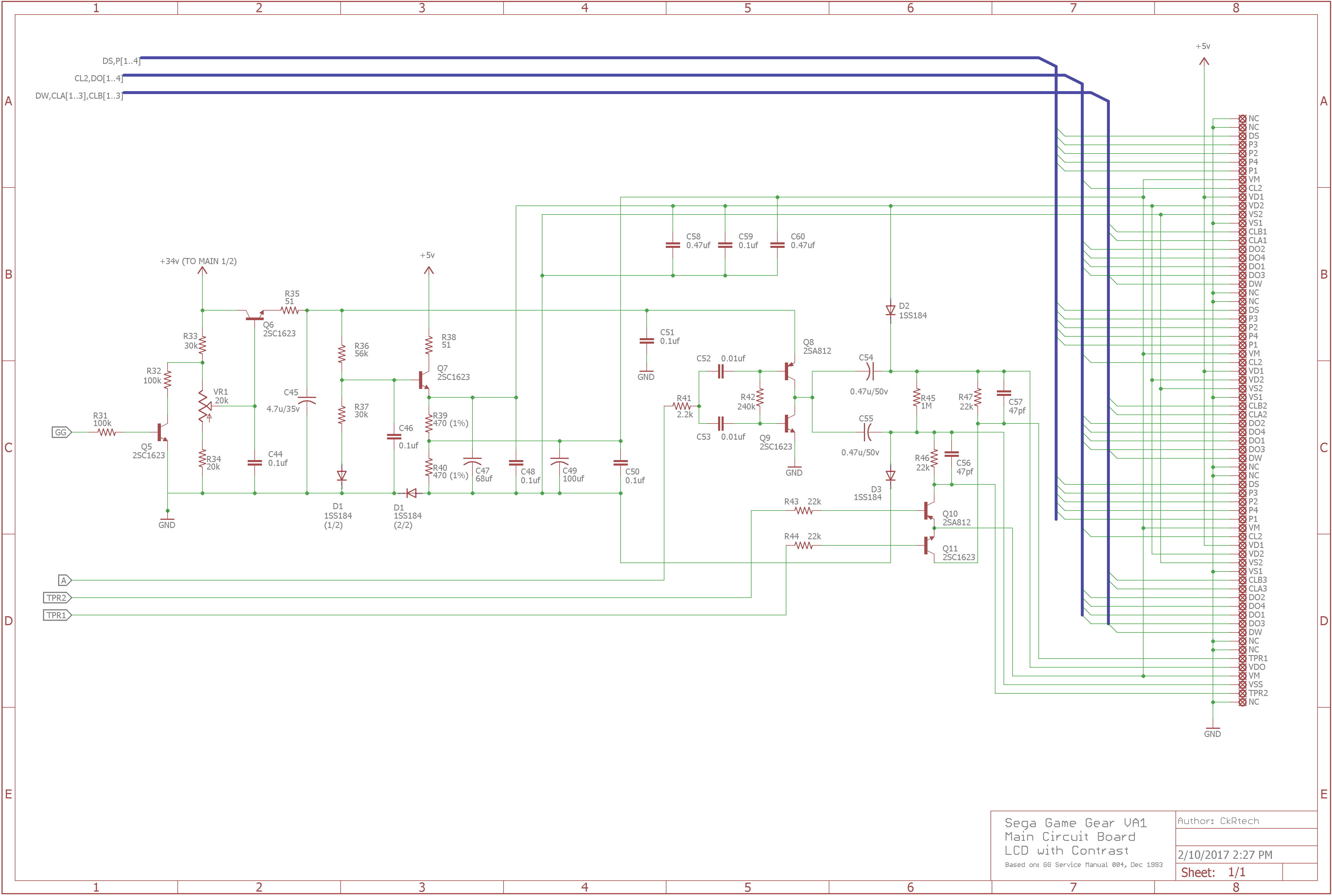

Sega Game Gear VA1 LCD/Contrast Circuit Schematic

    Hey guys,
    Had to do a lot of work with the LCD and Contrast circuit on the Sega Game Gear, and I was really slowed by the multi-generational copy with splotchy fonts that is floating around on the Internet. I recreated the circuit from the VA1 Service Manual no 4 from December 1993 to make it easier to read.
    Figured I would post it here in case anyone needs it at some point. If you see any mistakes or have any concerns, let me know. I'll update and replace the image as needed.
