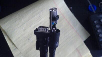

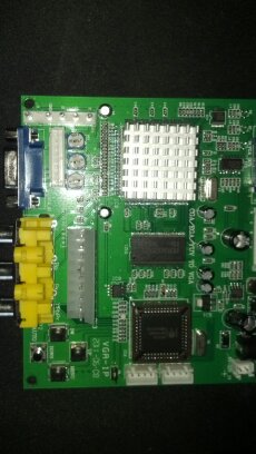

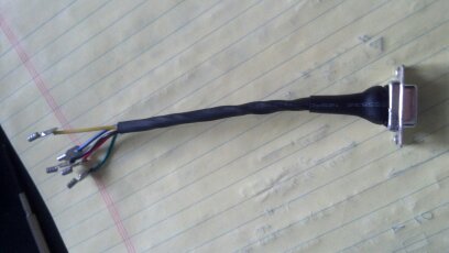

    So, I came across this converter, a CGA, EGA,RGB and YPbPr to VGA converter from eBay. Simple, PCB design with no enclosure made even more appealing to me. I managed to find a near perfect size plastic enclosure online to house the board. I had the chance to test the converter on a Dreamcast using the DC VGA cable. So, even when the DC can produce VGA signal with a high enough MHz (I believe 31) to be accepted in most of the modern LCD monitors without modifications/conversions. So, even when I couldn’t cay that the converter was “converting" in that test, I got to see that it was otherwise operational. There was a clean signal on the VGA output, the OSD menu (yes, the converter has an OSD menu, very simple, yet nice and straight to the point :nod:). Was visible and active. All the features on that menu did what they were supposed to do. So, I was happy with the performance.
    I'll be attaching some pics too.
    I decided to keep things nice a neat (my OCD:banghead:). Everything I make must have that stock (factory) look to it for me to live with it, otherwise it won't happen. Also, the other advantage of keeping this nice and clean is that it would make it a bit easier to use the same setup for multiple systems/consoles without major adjustments: All you need is to build a neat individual RGB cable with a male D sub 15 on one end for each of the consoles to hook up to the converter using a female D sub 15 connector I would fit on the enclosure's side that has multiple wires for RGBS signals to be carried into the board using pin connectors for quick swapping if that was needed.
    So, I found the cable for the job :thumbsup:The Belkin F3H982-06 All Black male to male VGA cable... It has three individually foil shielded actual mini coax cables for RGB, 3 single wire also individually shielded lines. Plastic and foil outer shield, all wrapped up an a mesh wire static sleeve shield connected to the metal parts of the connectors! I can't ask for anything better especially when it is all under 8 mm in diameter total cover and all!!
    Then I cut the cable a bit over the 2' long mark and soldered the DIN U 262 Connecter to the loose wire side corresponding the R, G, and B from the Genesis to the cores of the R.G. and B of the cable, combining the three (R.G.B mesh wire grounds together and soldering that to the Ground from the Genesis. Finally, got one of the 2 sync wires on the VGA cable to serve as the Sync from the Genesis.
    The problem:
    Can't get any Genesis Video on the monitor, just the converter menu is on with black screen background. I have tried many configurations to hook the RGBS from the Genesis to many of the input ports on the board without much luck :confused:what am I doing wrong here? Or, let me rephrase this: Anyone knows how to use this converter with a Sega Genesis 1?
    Thank you all in advance.

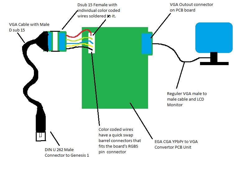

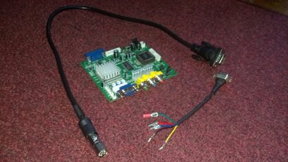

    Here are some pics, the PCB converter. The Genesis DIN U to D sub 15 Cable, the D sub 15 to individual barrel connector cable, and some other pics. A rough sketch of my plan here...

    Pics !
    Sorry, I hit enter before I attached the pics, here they are:

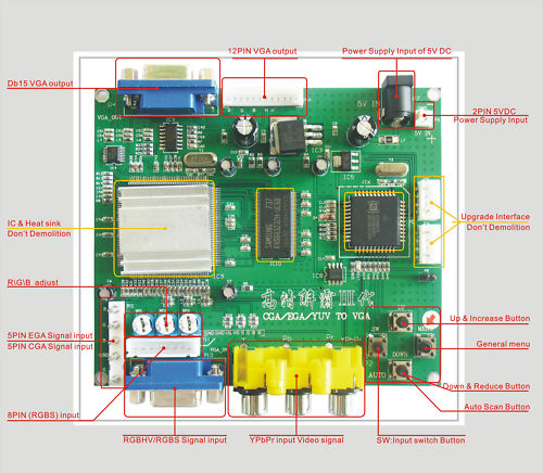

    2. As you probably know, the converter we have has the RGBS ( 5 pin ) input connector, see pic. The board has the folowing symbols prited on it R G B G S. Isn't that Red Green Blue Ground and Sync from the Geesis/MD outpot? I have tried connecting them to the Genesis without luck. Am I missing something here ?

    I do not see why you are going DIN -> VGA -> VGA > Header it makes no sense.
    In short, make your cable from the console (DIN) goto the correct pins on the DSUB15 (VGA) so it matches the table on that link. Then modify the board as per the guide.

    Thanks again. Well, the reason I decided to go with the Console=>VGA Connector and VGA connector=> board is to ba able to fit the second VGA connector ( female Dsub 15) on the plastic enclosure I have to make for a clean/quick connect/disconnect point whenever I need to swap consoles. This way, and by having a disgnated cable for each system/console I can swap them without having wires sticking out of the enclosure that's it.

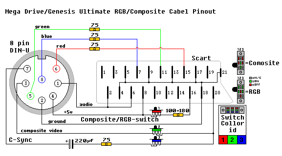

    Another question here... I do understand your point about the need to strip out the sync out of the composite video output. But, I was under the impression that the MD/Genesis HAS a sync out AND a composite video out in seperate pins on the DIN port. So, actually I have that C-sync connected to pin 13 for H sync and then switched it to pin 14 in the D sub 15 when I didn't get any video the first time. Unfortunatly, both tries were unsuccessful.
    Here's a pic of the Genesis pinout I have considered for that c-sync I mentioned.

    I never had problems with that upscaler board and my MDs and I used bare Csync from the AV out

    WOW !! What is your secret ! I am the original poster and I have tried 5 different model 1s ( High def and non high def ) and tried the Csync from port 7 out of the AV port with no luck whatsoever... :(
    So, PLEASE give us some details about the setup... What wire goes where...Which imput port are you using on the scaler board ( use my pic to refrence if possible ) the works... Cause I'm about to just give up on this setup ...

    Hsync is open drain, Vsync is probably open drain too, so you need a bit of extra magic for it to work.
    When you stress Hsync you'll mess up VDP operation aswell
