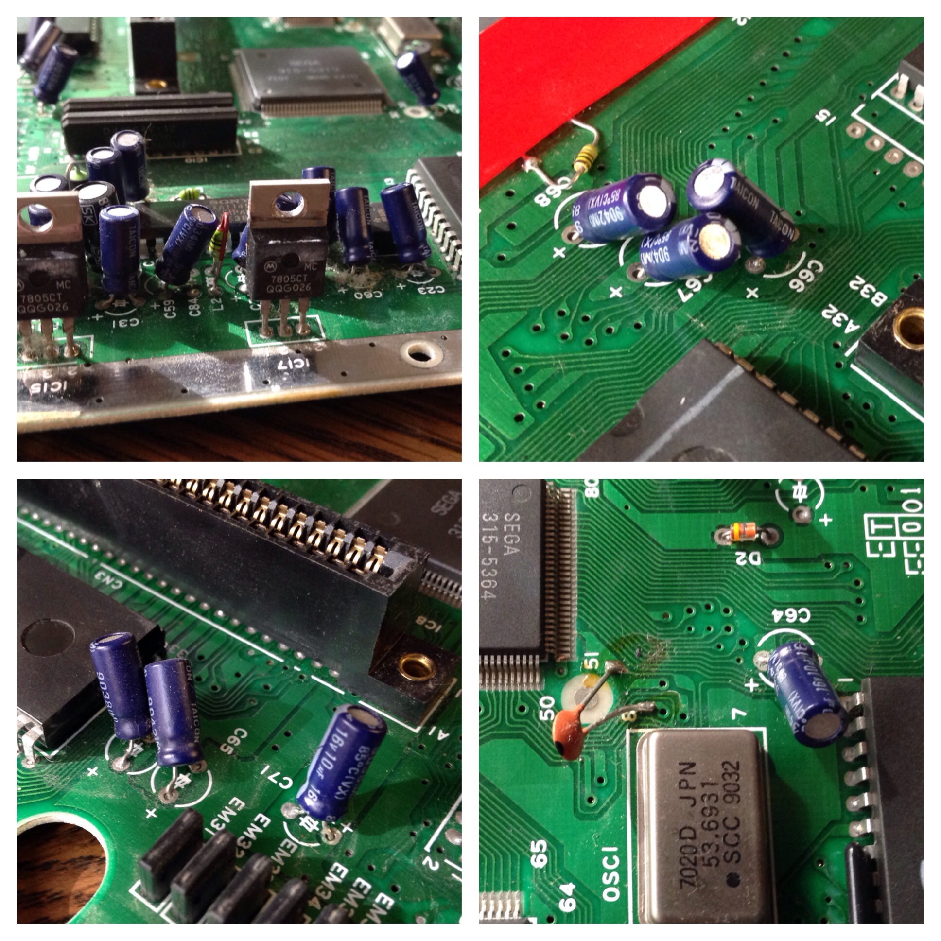

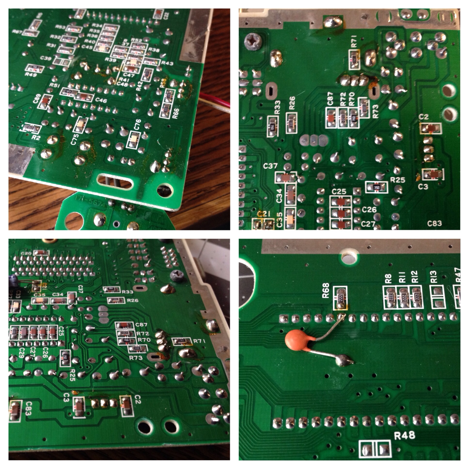

    I disassembled the unit, it was filthy. Worst I've ever seen. Rusty RF box, Lots of orange corrosive leakage on the PCB, especially on the underside of the RF unit and the Power.
    I can see caps possibly damaged or completely missing solder on some, but I'm not seeing any bulged or exploded ones necessarily. I have cleaned out the pin connector, removing a lot of hair!
    Looking at these images, can you tell me what I need to replace, caps and re solder wise, and offer any advice as to what is causing the video loss? I'm probably going to order a capacity kit, initially. Thanks
    - just seen a leg that's come away from solder (bottom left pic, 2nd set) on the corroded area C2. So that's one thing to do.
    - made up a video lead to check din connection... No video there either

    Why do you think it's caps? And what's that fluff all over the legs?
    Revert to basic fault-finding principles. Check voltages - input and on chips first.

    I get my meter tomorrow hopefully so I will do so then. But if it powers on, it's the graphics chip or something in that area at fault, right?
    The pics show the caps and the brown leakage, what's that from? - one suggested step would be to change them, as recommended by a few people on forums, not saying its gonna fix it, or that they even need doing, this is why I am uploading the pics for you guys to offer your opinion on them, and the general state of the board.

    Edit: I am not sure as to what you refer as the brown leakage. But maybe you are talking about the flux residues. Which is normal.

    Most of my other boards don't have the brown sticky (corrosive also, a guy said) stuff around the underside of PCB, under power and RF units- just wanted to ask the experts whether it needed to come off and whether it was a leaky cap (as I've never had any caps that need replacing, I'm having to learn as I go)
