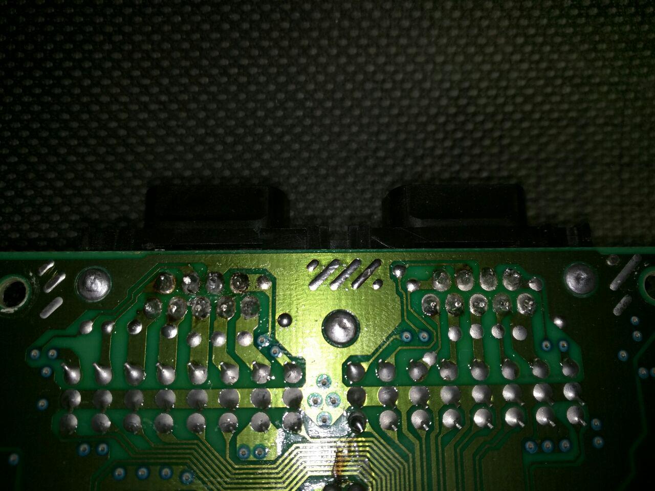

    I would like to know if you have some experience with genesismodel2 controller problems. i bought this genesis on ebay a week ago but controllers didnt work at all. Later on, i found out that if move the controller plug upwards it will make the controller to work.
    I tested the controller port with conductivity from the pins to the board and they seem OK.
    is there a way i can test the controller plug? if the problem is the controller plug.. do you guys know a way to fix it?
    thanks!!!

    Sounds like you just need to reflow the solder joints on the controller ports, just heat them up with a soldering iron, add a little extra solder and you're done.

    i tested the joints with a voltage tester (on conductivity) and they were ok. do you think i should reflow anyways?

    You should reflow the ports. After 25+ years, the solder can become all funky and stuff. Hell it might just be the controller itself maybe.

    will do guys.
    i will post pictures with the results..
    thanks!!!
  6. jjuaristi
    jjuaristi Newly Registered
    Apr 7, 2014
    it worked! thanks guys!
