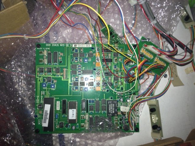

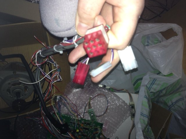

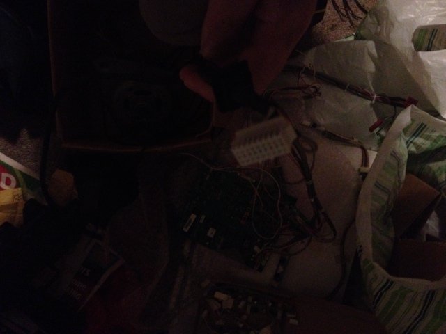

    showing connector of gun....the gun I/o board......and the connector from gun I/o board/protection board

    The bottom 9 pin one is the same as on my NAIMO2 machine and is for buttons on mine, there are two, one for P1 and another for P2, interesting to see that you only have one though.

    no I do have one for each player. Sorry I didn't show it on photo
    Ive been told ive got everything I need, I simply have to cut the connectors off and join the cables together with splices or such

    The connectors you have in your hand - the 9 pin is a standard harness for all Sega IR guns (used from HOTD2 all the way to HOTD4, with VC3 in there as well). Sega changed the molex connector a few times during the ten year cycle these guns were being produced - probably to make sure the individual part numbers stayed the same and people didn't simply replace say a HOTD2 gun with a VC3 gun.
    The little two pin connectors are for the button on the side of the VC3 gun. The VC3 guns you should have are blue with a black trigger, and a button on the left side of the gun.
    I have a ton of extra housings and gun parts for VC3 (I got to pull from the aftermath of 4 machines that were parted out at an auction), so if you need anything I'll try to help.

    Oh sorry, no I don't have VC3 guns. I have HOTD4 uzi guns which have that top connector, somehow ive gotta make it work with the 9 pin connector
    Im confused why HOTD4 has so many wires etc compared to the 9 pin. Perhaps that 2 pin connector as you said is for connecting into it as well for buttons
