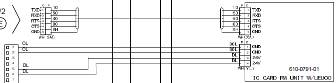

    Well, yes and no. From the small pcb on the control panel the wiring goes directly to the serial cable port on the lindbergh. I've asked one person and he is researching it at the moment. He will get back to me soon.
    Edit: Looks like you are talking about the Initial D wiring. It's very different from the normal sega ones, but I do have information on how to wire it up.
    This is only for Initial D 4+5 wiring. Btw if I may ask, where did you get your hands on them? I've been looking around for a while.

    thanks for that. Yeah I knew it goes to serial port
