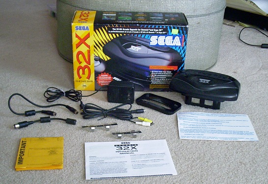

    Mega Drive 2 is capable of composite with stereo.
    But Sega indeed released a 1st party mono cable. It's included in the box with 32X.

    Yeah to compare, here's the real Sega mono model 2 cable:
