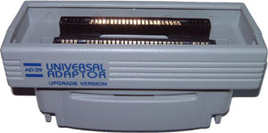

    The most ideal solution would be if someone could make a tray with switches to select what cart to use, eliminating cart swap.
    ROM/RAM/MEM/AR/Modem
    eg like this:
    ...but with one donor cart + cable connected to seperate tray next to the console...
