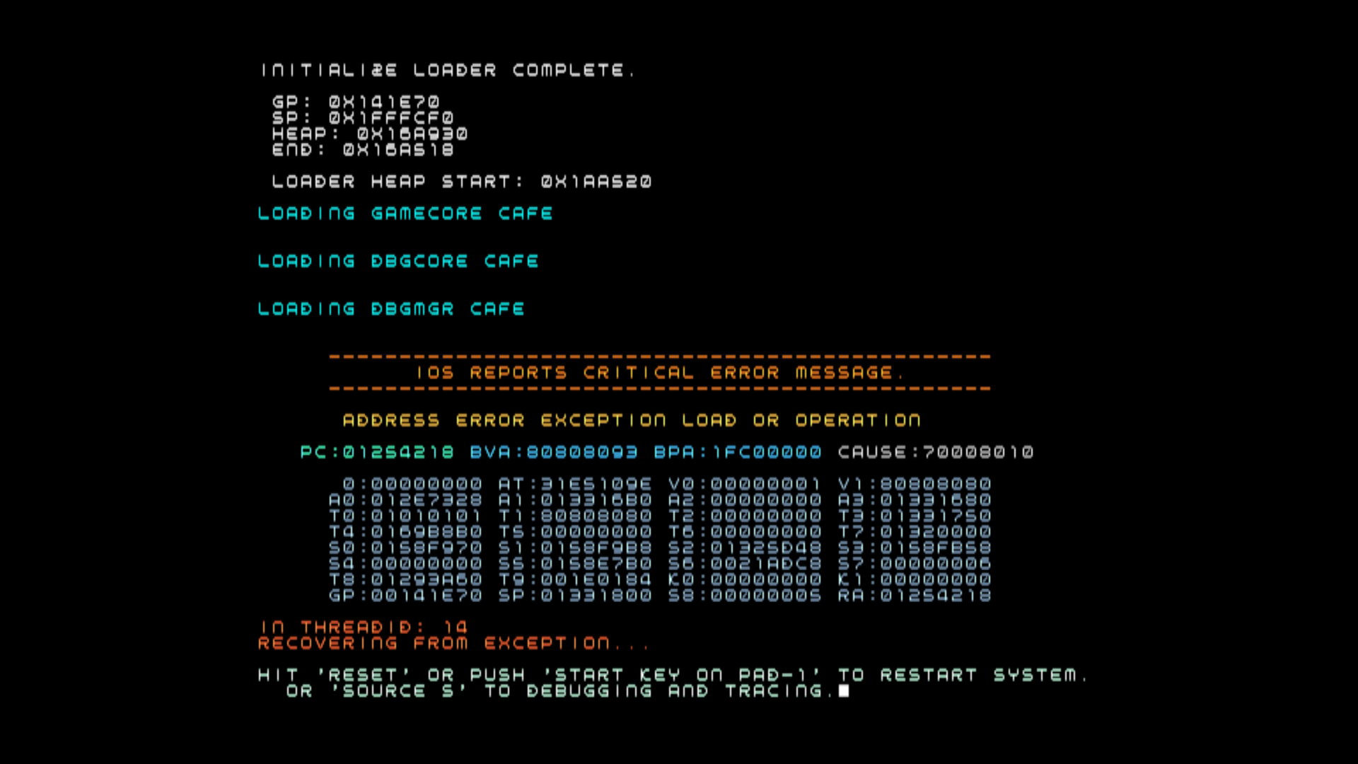

  17. PixelButts
    PixelButts Site Soldier
    Aug 19, 2014
    2,665
    1,808
    It booted but it crashed on boot as you can see. Hitting the start button as instructed doesn't do anything so uh

  19. PixelButts
    Aug 19, 2014
    2,665
    1,808
    Apparently that works

    Thanks to further feedback from nonijod, it turned-out that there are actually three issues:
    - Incorrectly built ISO (not with CDVDGEN) did not run at all on PS3 (and perhaps also PS2 from DVD). - Fixed by building with CDVDGEN.
    - The controller having to be reconnected soon after booting the game, or else it would crash as shown by PixelButts above (due to allegedly missing sheet file). This seems to be fixed in later versions of the debugEnabler (debug menu), so I probably fixed it and forgot about it. Although it seems the controller still needs to be reconnected, otherwise the game complains the controller is missing (on the PS3 only).
    - The age-old bug with the game randomly "thinking" that certain files are missing on the CDVD. Further tests on PCSX2 showed that it is caused by calling sceCdLayerSearchFile() too soon after other CDVD functions were last called. sceCdLayerSearchFile() calls PollSema() internally, which fails if the semaphore is not free. What happens is that the last use of CDVD resources, kept the semaphore busy, and even after the return of the last function (whatever it was), the last iSignalSema() was not yet called by the time the following sceCdLayerSearchFile() called PollSema() resulting in it returning -1 and sceCdLayerSearchFile exiting with missing file flag (0).
