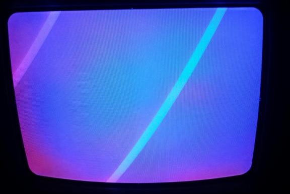

    Long story short the thing was not packed for the rough handing of international shipping. Case has cracks and unit has several faults.
    The most alarming fault is the CRT output, seems to have purity issues. Excuse the bad mobile phone shot but it demonstrates the red on the blue screen.
    I was hoping somebody could confirm if this is may be permanent impact damage; perhaps the shadow mask has been dislodged and is unfixable.

    Thanks for the idea. I have every soldering tool except a soldering gun like that. I take it this is a poor man's substitute for a degaussing wand?

    I think it is.
    Another method is this:
    http://www.wikihow.com/Demagnetize-a-TV-Screen
    I had accidentally magnetized a corner of my TV once,and this guide did the trick to return it to normal.It actually worked.

    A transformer, as big as possible. plug it in ac socket then move around the screen (as close as possible) in circles and then move away from the screen (again in circles), don't turn it off while it close to the screen as it can result in quite opposite thing - it will magnetize the mask.
