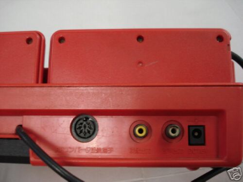

    This is a modified New Famicom which uses RGB:
    http://page5.auctions.yahoo.co.jp/jp/auction/e69329198
    It sold on Yahoo a few weeks ago, got almost $350.
    Looks like the Sharp Twin Famicom has a port called "RF Converter." You can use Neo Geo or PC Engine AV cables with it. I couldn't read the Japanese in the picture above but now that I'm looking at a picture of a Titler I can see it more clearly:

  15. grizwaldo
    grizwaldo Guest
    Thanks for the replies. I'm confused about the sharp twin famicom. Can it output rgb with a neo geo rgb cable and no modification?
    thanks
  16. Jamtex
    Feb 21, 2007
    5,472
    No, but it will output composite video.
