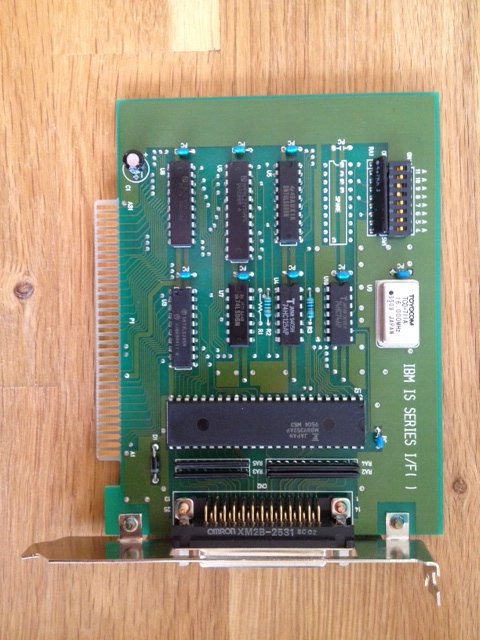

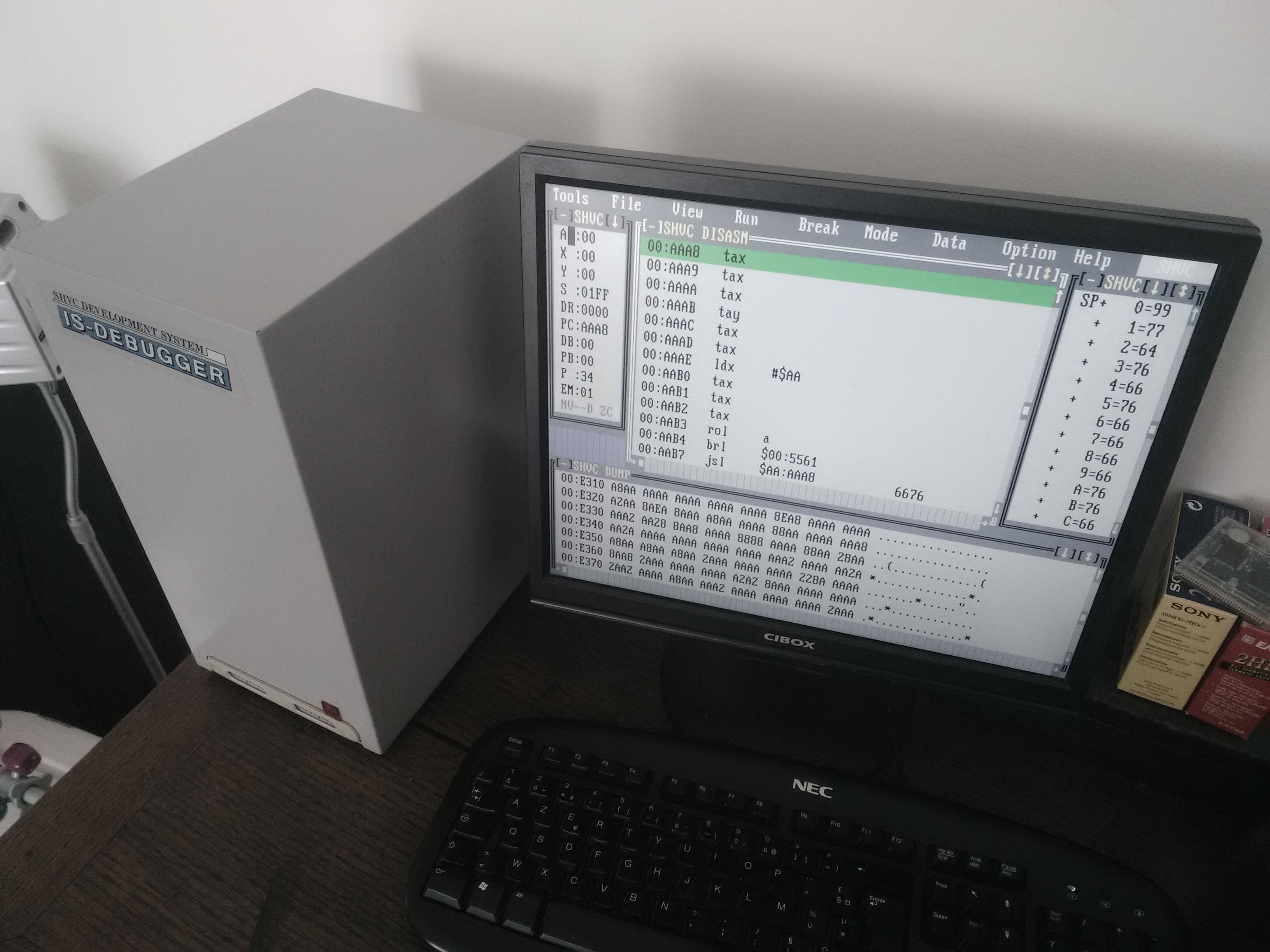

    Hello!
    I finaly can make it work! For information, look at the picture of the interface card (Thanks to DanB from PlanetVB).
    If you don't own the original interface card, you can use a generic one with the ASPI drivers.
    Here is my config :
    - Intel 486DX2 Processor
    - Standart VGA board
    - 64Mo RAM
    - Tomatoboard 486 PCI Mother Board
    - Adaptec AHA-1540CF/1542CF ISA Board
    - 3 buttons SERIAL Mouse
    - 6.22 French MS-DOS

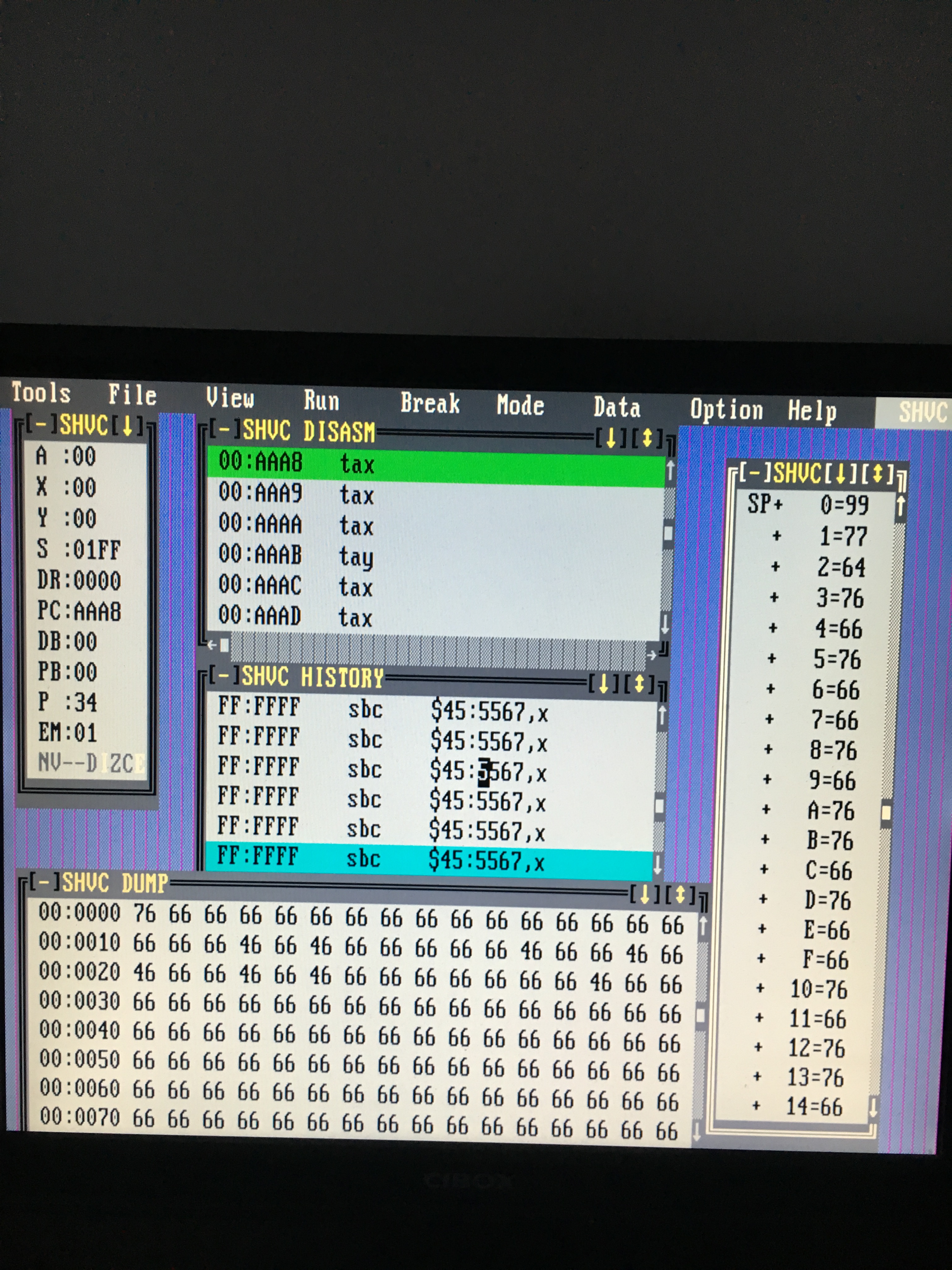

    ISW is a great debugger working under DOS System where you can dump RAM/VRAM and use many others features.
    An assembler (ISAS) and a linker (ISLK) are provided too. You generate an ISX file with information for debugging included.
    You can debug sound (thanks to SOUND menu) if you own an IS-SOUND or a SNES Emulator-SE.

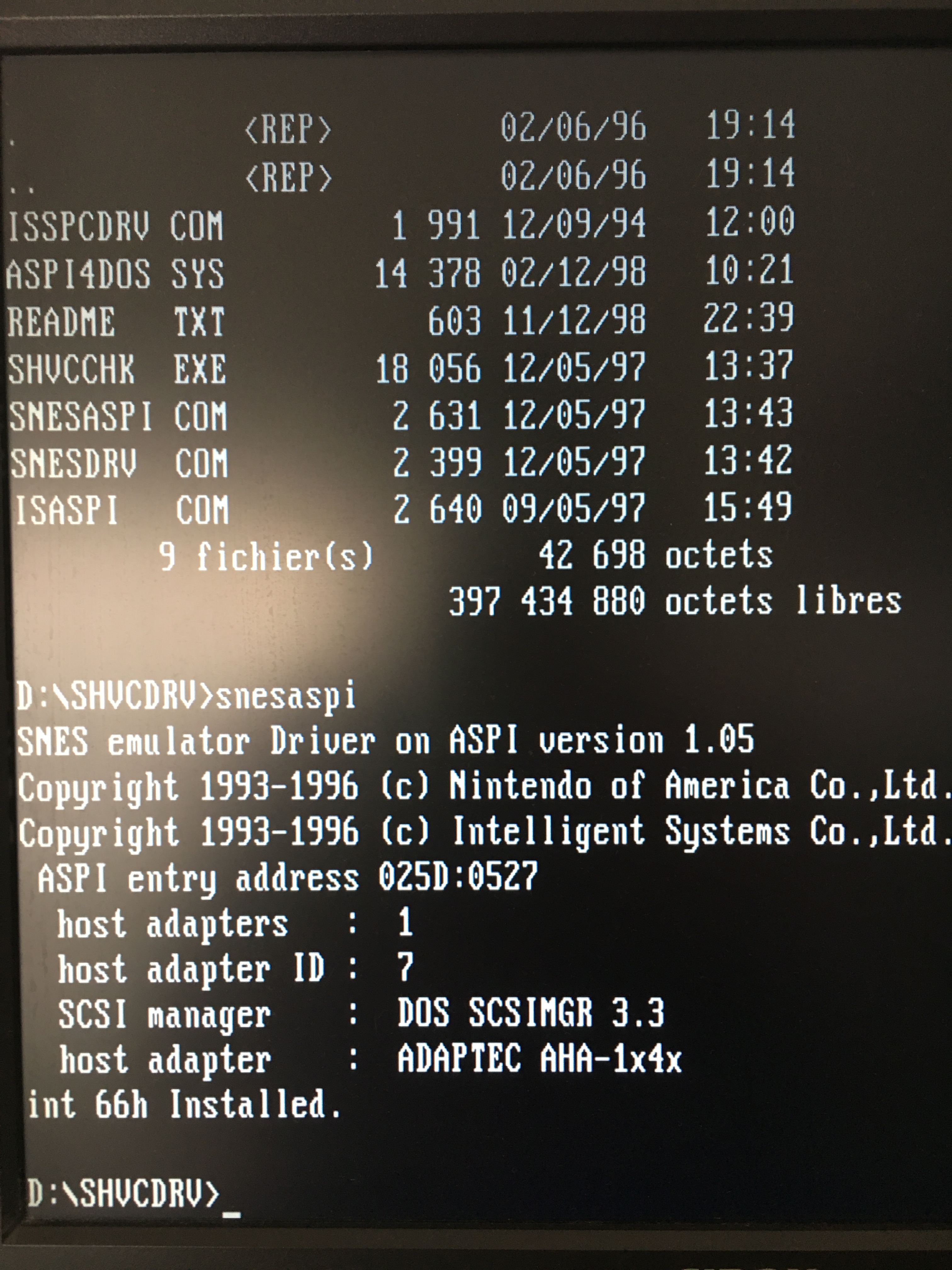

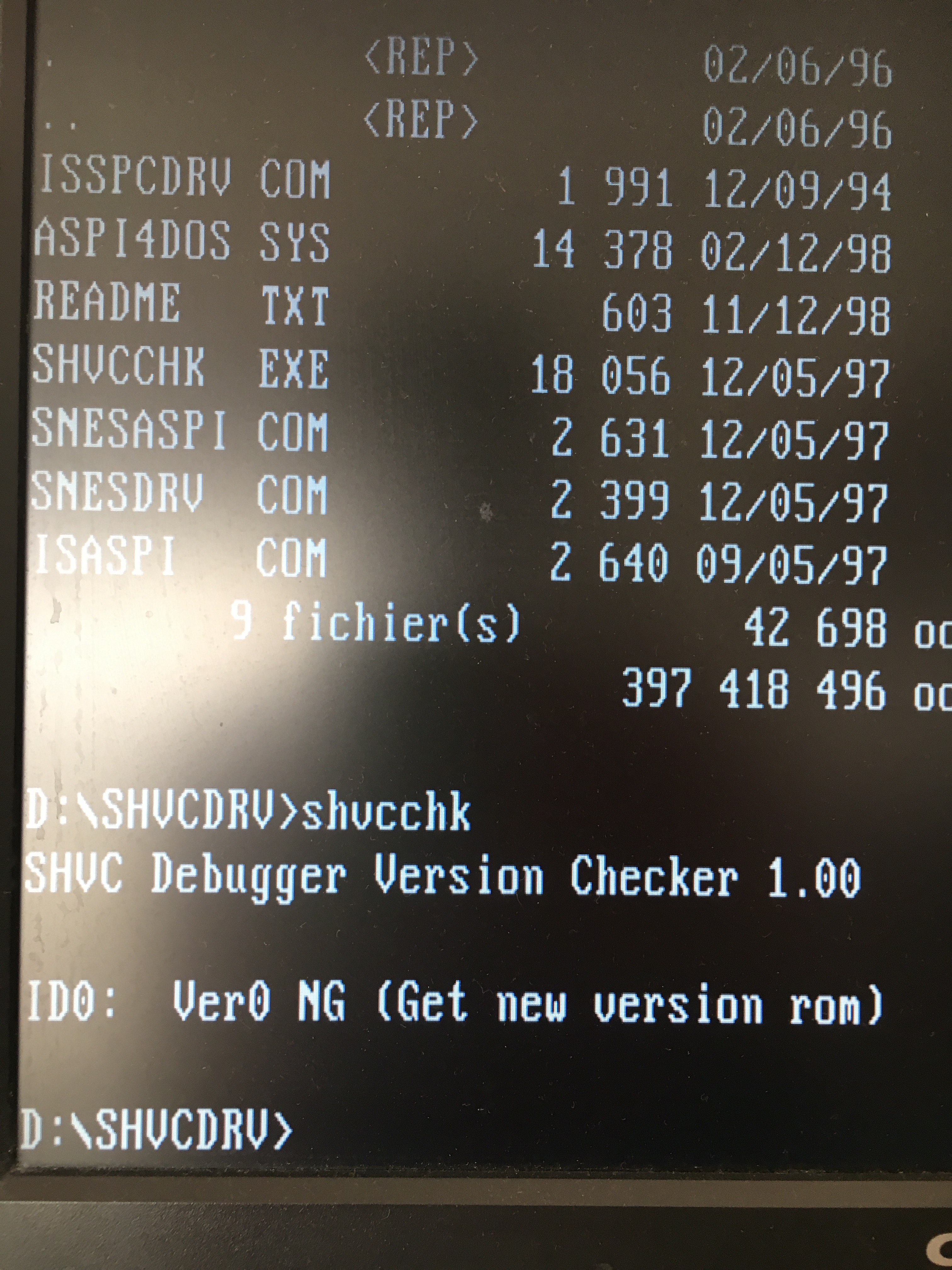

    After a couple of EMULATOR-SE hardware problems, I have finally tested it.
    Once I loaded the SNESASPI driver and ran the SNES debugger, I finally can say it work with SUPER NES EMULATOR-SE.
