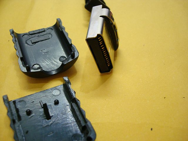

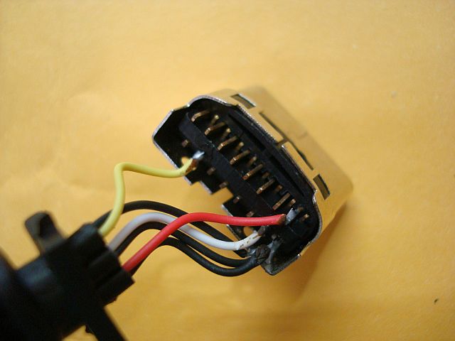

    The cable itself does not have more than 4 wires of course, since it's a composite video cable. But the plug does have all the contacts, here some pics of it:
    I have successfully made a VGA cable with it, unfortunately I don't have pics of my work. But it's easy to open the connector with a stanley knife. Isn't too hard to solder some wires in it.
    Anyway guys, keep in mind that is a chinese/cheap product... It does not have the same quality construction that an original product does. But it does the job and I think it's the only option available to make a VGA cable for the DC.

    Hey thanks! It's nice that you can open it that easily! I guess darc will buy a few right now!
