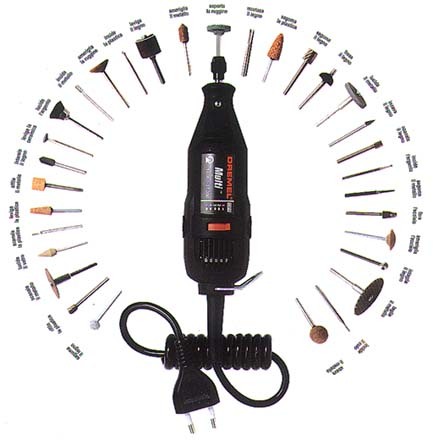

    One word: Dremel.

    You can cut the ridge down with a sideways box cutter. Dremel puts out too much heat, and cuts way too fast. Plus you can't get shallow enough angle to make it flat.
    Sideways box cutter, and patience.

    Dremel works fine. Any decent one is adjustable RPM to stop you melting the plastic.

    There are bits for just this sort of thing ;)
