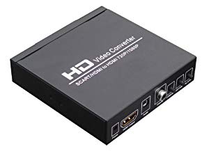

    You are right, perhaps the upscaler option is the one thinking it is PAL-M. This is like the converter that I have:
    Any idea to which revision of the SNES or SFC are the chips a copy of? or is it a total new design?

    I have that same converter. I had trouble with my dreamcast on it. Kept saying s-video was PAL when it was NTSC and it kept swapping between composite video mode and s-video mode.
    Nice console though. Never seen anything like it before. I think the chips are the same for all SNES consoles minus the CPU revisions, which are interchangeable.

    It seems to be a converter problem then. I'm going to take it apart and trace the signals to see where exactly they go to. At first I had the switching problem too, one just have to make sure the scart cable has the switching pin tied to +5Vcc with a 100 ohm resistor. Thanks for your input!
