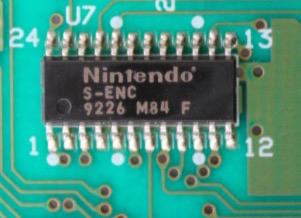

    You've got one of these little guys right?
    BA6592F should be a suitable replacement according to Console5.com. There's a few on eBay, mind you this is all trial and error. If it fixes it, awesome! If not, look to the next part on the list... which would be very bad if it is a PPU!
    I had a similar issue with yellows / reds flickering on a Mega Drive and replacing the Sony video encoder fixed it up a long while ago. It was a good fix for such a cheap part. ASICs are bad for this reason when something breaks! :(

    Yep, one of these are mine. I'll start changing it, it would be amazing if it's the solution so I'm going to buy it asap.
    Soon I'll post the feedback, thanks guys!
