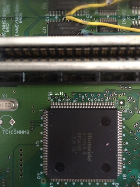

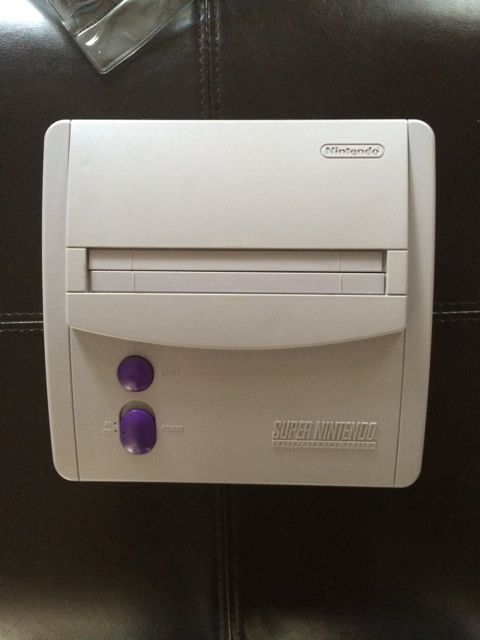

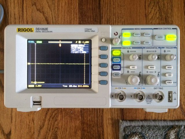

    SNES-Mini (SNN-CPU-01) and Rigol 1052E Oscilloscope
    RGB Measurements taken from vias right off the 1-chip pins
    I also took measurements at the Multi-Out. Currently, I have the RGB lines connected to the RGB out pins of the S-RGB IC with 75 ohm resistors on each line going to the Multi-Out pins. I also connected the CSync pin of the S-RGB to the Multi-Out.
    The measurements were taken with a 10:1 probe (in 10x mode on the oscilloscope and probe) and in DC Coupled mode. I used the 240p Test Suite's White and RGB screen mode.
    The measurements at the RGB pins (R, G, B):
    R is slightly lower in amplitude(?). Amplitude ~0.8mVpp.
    Measurements for RGB at the Multi-Out (R, G, B):
    Amplitude is ~1.6Vpp. Strangely, R's amplitude is the same as G and B, where in the signals off the CPU, it was lower.
    Black level at R pin near CPU, and R Multi-Out (Cursor B shows offset of signal). Last is CSync at Pin 3 of Multi-Out (Run from S-RGB IC):

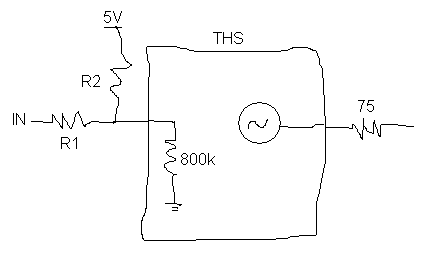

    R2 pull-up is only necessary if the offset needs to be shifted down, in which case R1 will need to be lowered.
    Without it:
    (0.8V / (R1 + 800k)) * 800k = 0.7V
    R1 = 110k
    For better accuracy use an external pull-down, 75k ohms or less so it will be minimally affected by the low-tolerance 800k in parallel.
    Something that also might come into consideration is the DAC's construction. It would be very helpful if someone had an accurate schematic of the full signal path. Typically these old DAC outputs can only sink or source current, so a current sink/source load is necessary to get linear operation (or measurements). Maybe this is internal to the chip, maybe not. If not, the measurements will need to be scrutinized.

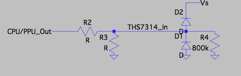

    I'm waffling between using the DC Coupled input or the AC Bias input method. AC Bias would be the "proper" way, but since the RGB outs from the CPU/PPU are already 0V offset (assuming the measurements above are correct), DC Coupled could be used, since the THS7314 applies a bias shift internally. DC Coupled would also cut down on components needed.
    This is the current setup on the SNES-mini:
    Measurements in the first post were taken at the CPU/PPU pins.
    This is the DC Coupled circuit I'm looking at (note, the diodes and 800k are internal to the THS7314):
    R2 needs to be .143 the value of R3 to get 0.7Vpp from the raw signal. Calpis, you think using the 800k with R2 is a better way for the voltage divider? I didn't even think of using that.
